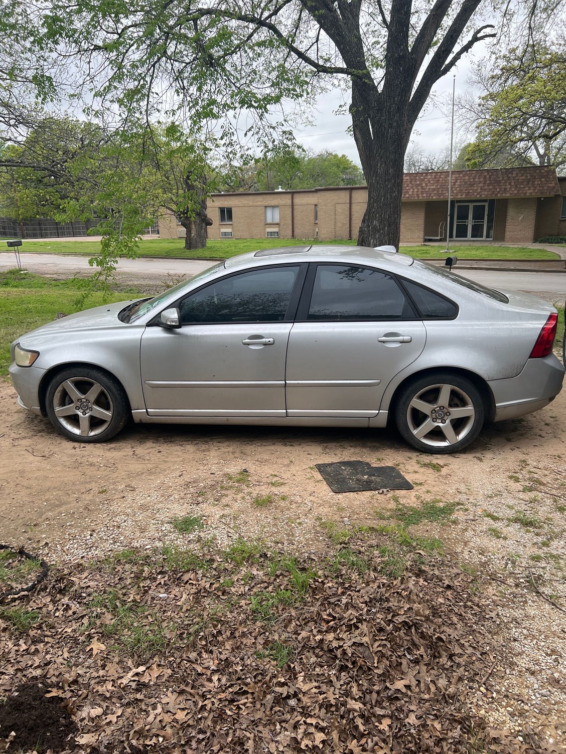

Hey everyone I recently became the owner of a… well broken down 2008 s40 2.4i. The scanner picked up DTC codes p0336/339 p1719, p0420, and p0012. With the state that it’s in upon getting it I just want to engine swap it and make it a project car. I’m considering throwing in a j32a2 engine with its transmission as well. I was hoping to get some opinions on that and also some help on how I can get rid and fix those codes. I reset the codes and the only one to stay was the p1719. The car cranks but won’t start at all
