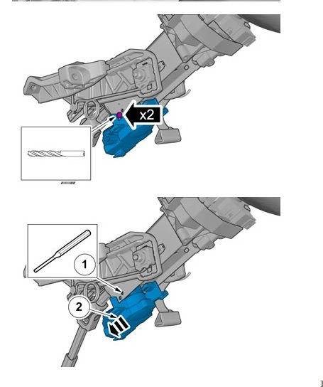

I've never done one but my techs have and did not complain - here's the VIDA instructions - drill two bolts and use a punch for something

Thanks so much. I will give it a shot tomorrow night.

Worked great. I had to jiggle the unit and put the key in/out a few times before the I could get the tab to depress but was able to get it free eventually.
Thanks, Hoonk!

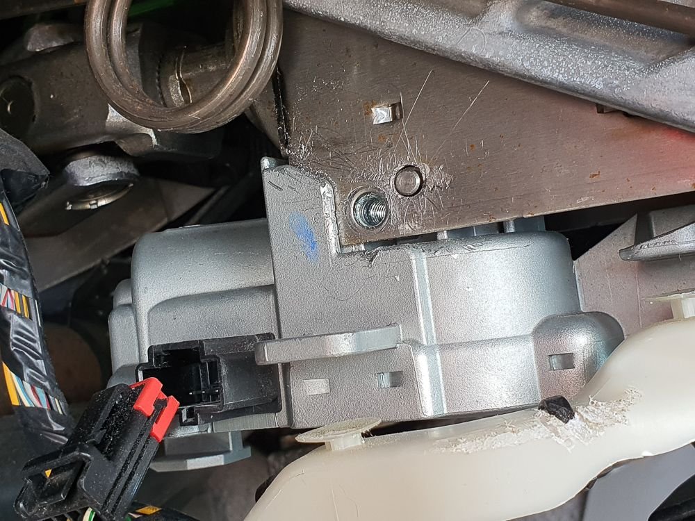

Same problem here. 2004 Volvo V50. I managed to remove the sheared-head screws by cutting a slot in their heads and thought that was the hard part done. But, the lock is still held in place by something. I presume it is the small piece of metal that requires a hole punch as depicted in the VIDA diagram. But I have been hitting it as hard as I dare with a punch and it will not move. As a result I cannot get the lock out. I'd be grateful for any ideas as I'm in a bit of a fix.
Thanks in advance.
