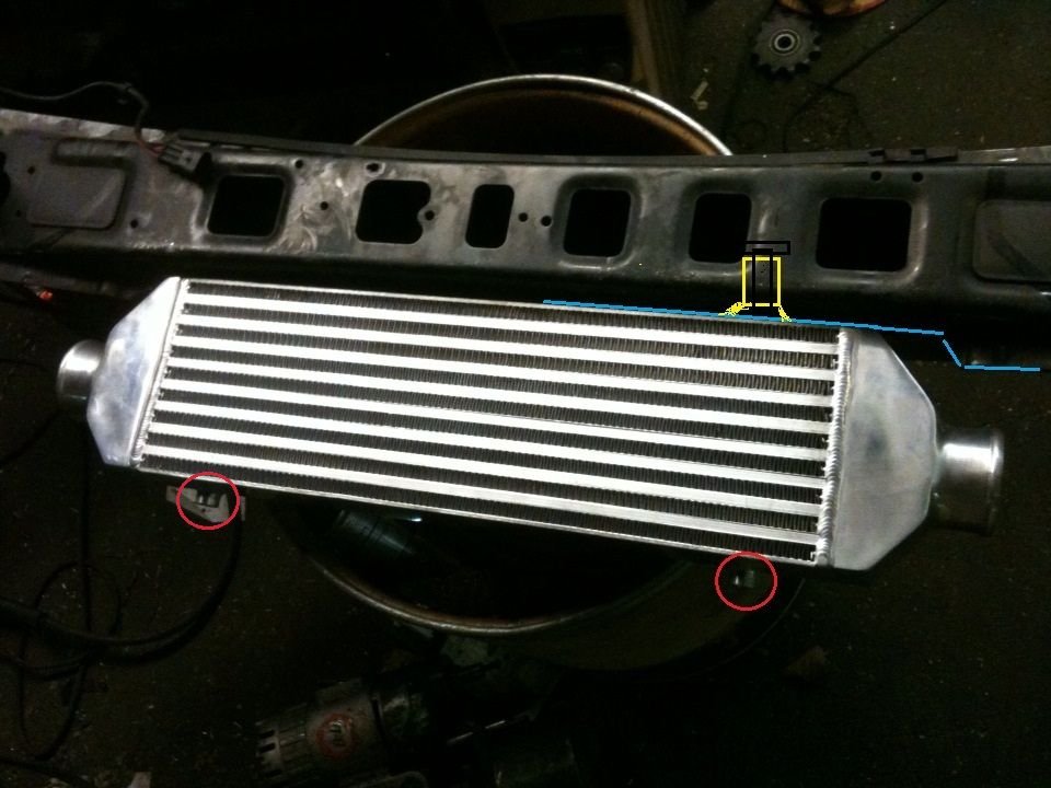

Your car would benefit greatly by installing a FMIC just like mine.Getting a bigger one just to replace the OEM one on the same spot will do nothing for you.
I was gonna do front mount. I havent measured to see what will fit. placement same as where yours is in that picture... but i want to cut out some of my plastics for more exposure

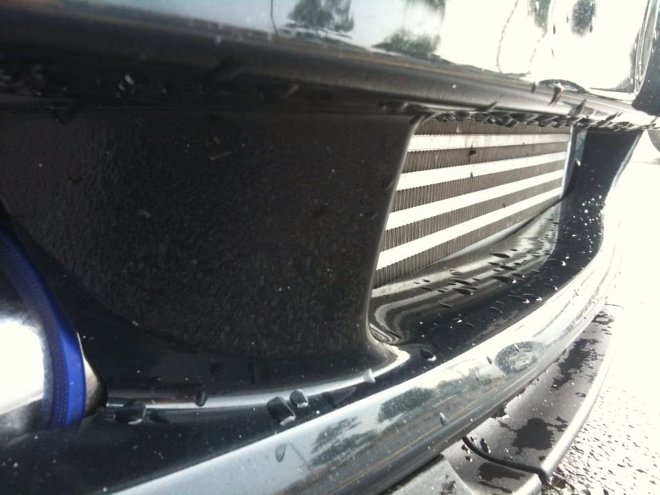

You gonna have to cut some but do go crazy.See my pix in my album.I didn't have to cut the opening bigger only had to cut space for the depth and the pipes.
thats exactly the size im looking for. the stock intercooler seems so restrictive it looks like a radiator. tiny tiny passages. do you recall the kit or the dimensions of that intercooler? it looks like it fits perfectly. I know it must have better top end performance, does it kill any down low torque or response? turbo lag?

I did measure the core is 20" then 4" on both side for the pipes.I think it is 7"tall and 2.5" deep and 28" overall in length.

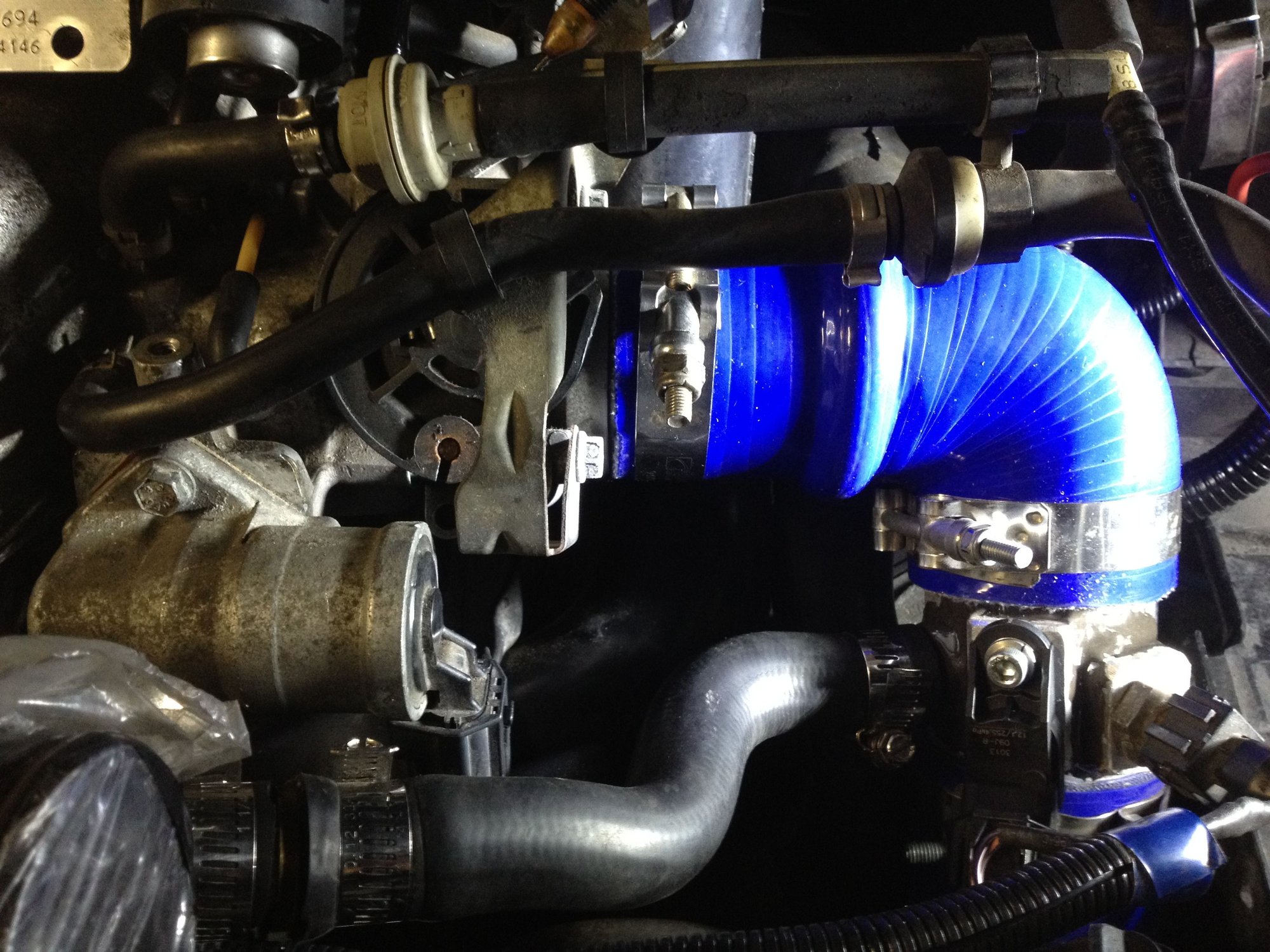

I made a pipe to accommodate the IAT and the pressure sensor.Rather ghetto as I didn't have access to a welder so I used J&B weld to mount the Alu block with the holes/threads to the pipe.Its been like this for about 10 years I'm guessing it will stay this way.
