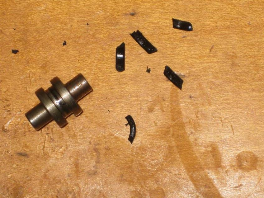

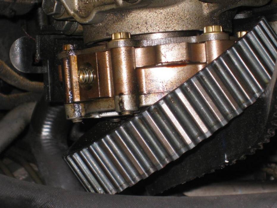

My 2001 had 4 cam seals total. The front intake cam has a normal seal behind the timing belt gear and the other end is a large plug type seal the fits between the head and the cam cover. The rear exhaust cam has 2 regular seals, one behind the CVVT gear and one under the cam position sensor cover. A leaking cam seal will leak oil down the front of the engine, annoying but not destructive. A leaking CVVT gear will put hot oil on your timing belt. This is bad. When mine starting leaking heavily the timing belt skipped several teeth and bent all 8 exhaust valves. Personally I wouldn't drive the vehicle until the CVVT gear is replaced.
The CVVT gear has a little plunger thingy with an o-ring. When this o-ring starts leaking it slings oil all over your timing belt. It is possible to fix the o-ring leak without removing the CVVT gear.
Normally people replace the CVVT solenoid first, as mentioned above, because it's fairly cheap and easy to reach. If that doesn't fix your P0015 then replace the CVVT gear itself. This takes a cam holder tool because the CVVT gear can be mounted incorrectly without it and you have to put 80 lb/ft torque on the single bolt holding it to the exhaust cam. You do not want the cams to move at all. I made that mistake once already.
