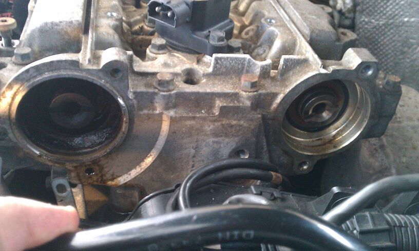

I have replaced the VVT solenoid, the timing belt, the exhaust cam gear. When I replaced the exhaust cam gear I found that the cam was off by 3 teeth! Yet it still ran pretty good. Now it runs really good, purrs like a kitten - but it still has the codes.
My registration (which has already been extended 4 months) will now expire and the car will not be legal on the highway.

Can I ask why you posted that picture? It shows cam timing that is way off. The slots in the ends of the camshafts should both be horizontal I believe.
Also, how long have you owned the car? Has it been neglected in terms of regular oil changes? There are oil passages in the VVT end of the exhaust camshaft that might possibly be blocked and cause the P0015 code.
That's why I posted the pictire - to show how far off it can be and still run. Yes, the slots should be horizontal and I purchased a tool to hold them that way.
I wanted to post this so that anyone else that gets a P0015 will know to check this right away. Before this I replaced the timing belt and the VVT solenoid and both times I did not bother to look at the back-end of the cam. When I replaced the belt I went by the marks that someone else painted on.
I should have looked at the back-end of the cam!
When I replaced the VVT solenoid I checked out the oil passages, they are nice and clean. No gunk build-up.
