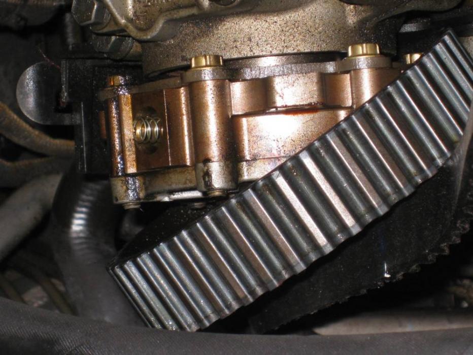

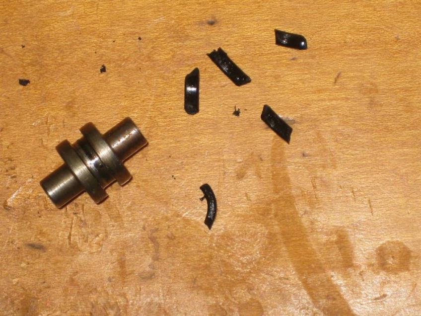

The last time mine failed it cost about $150 for the gear and another $50 for the cam holder tool. That gear was itself a replacement for the OEM gear which started leaking oil from the failed o-ring. I'm guessing somewhere around 5 years old.
When my CVVT gear starting leaking oil from the failed o-ring I removed the top timing belt cover and started the engine. The leaking oil was slung out in plane with the gear. It went all the way up to the bottom of the hood and forward to the bumper and beyond. I don't recommend getting in line with the belt rotation if you try this. You will get hit with oil.
