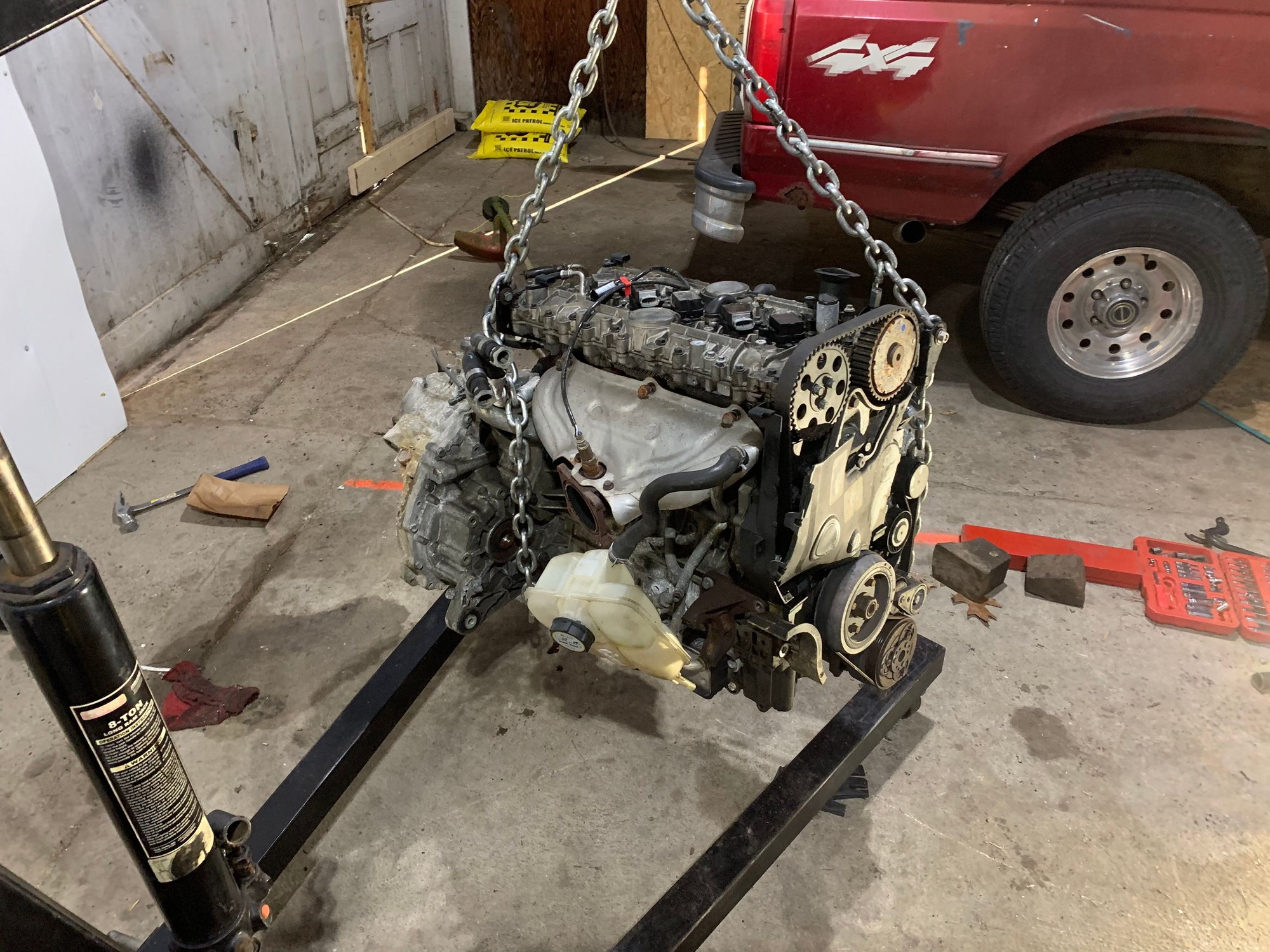

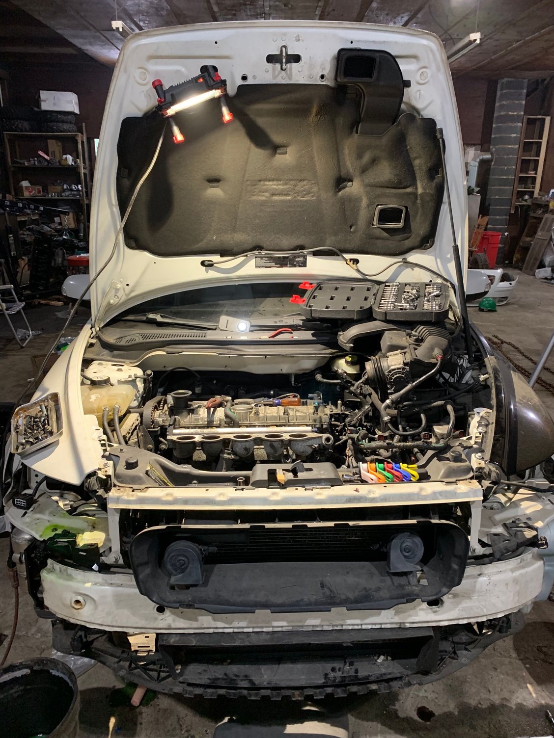

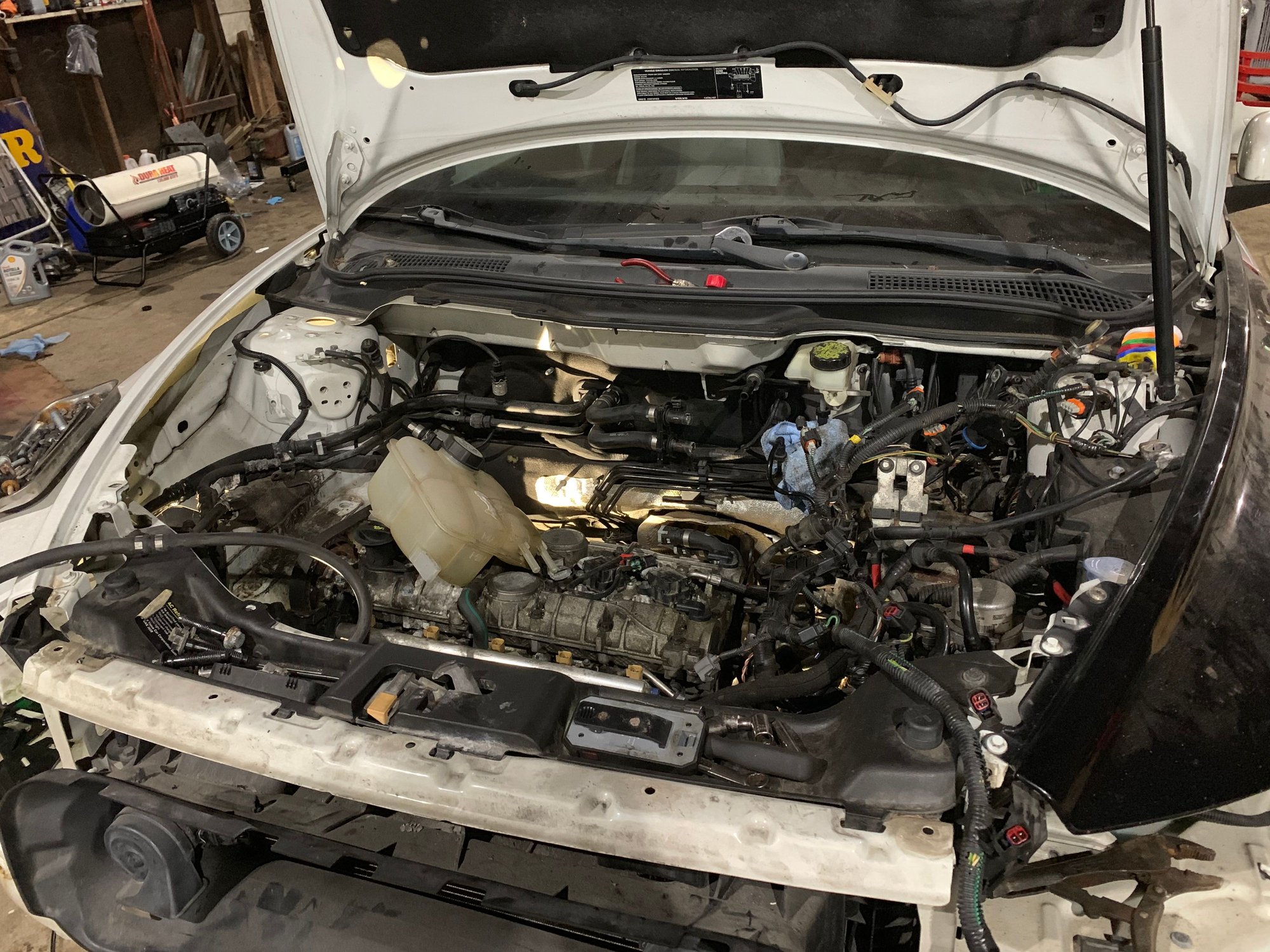

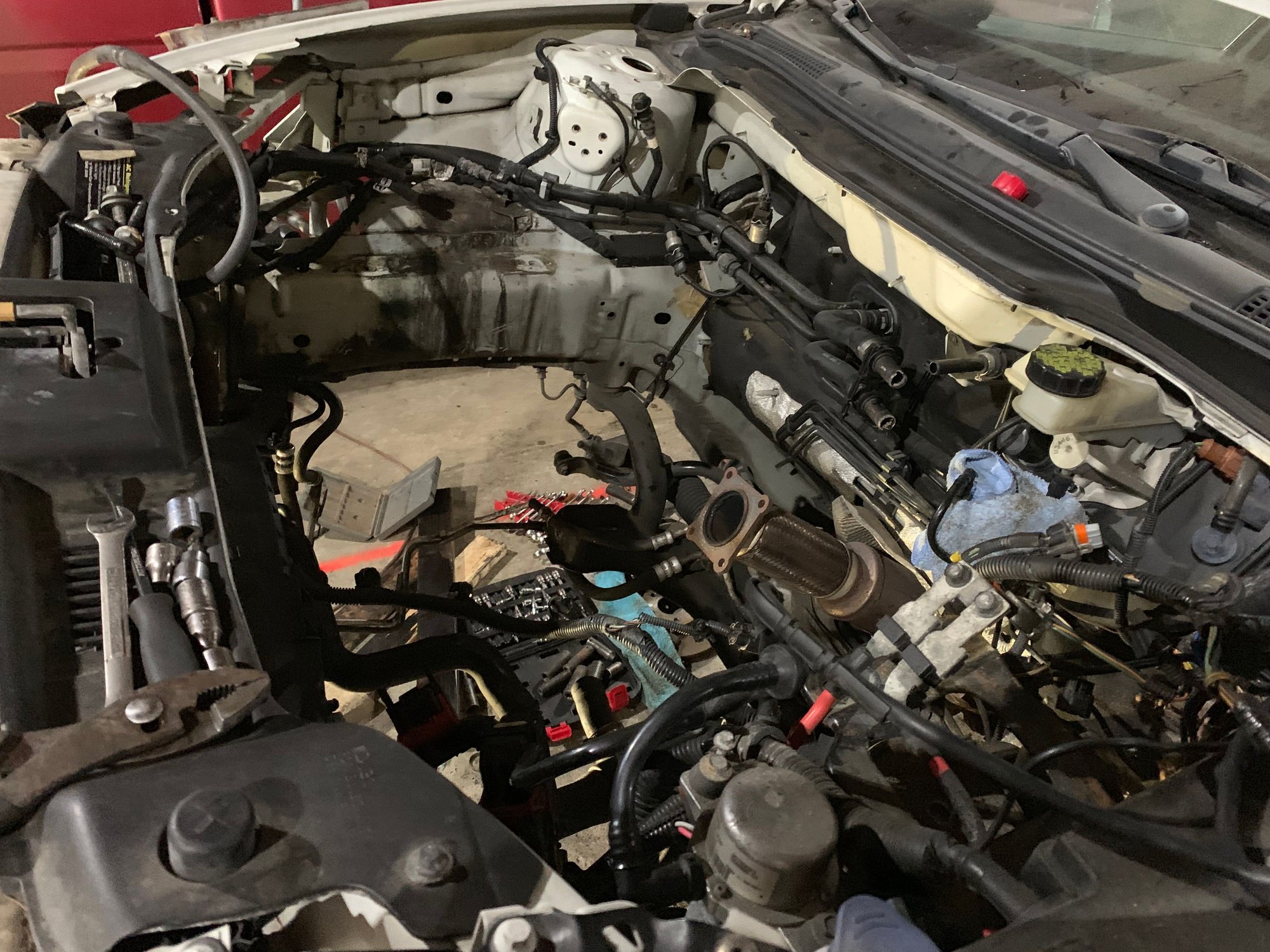

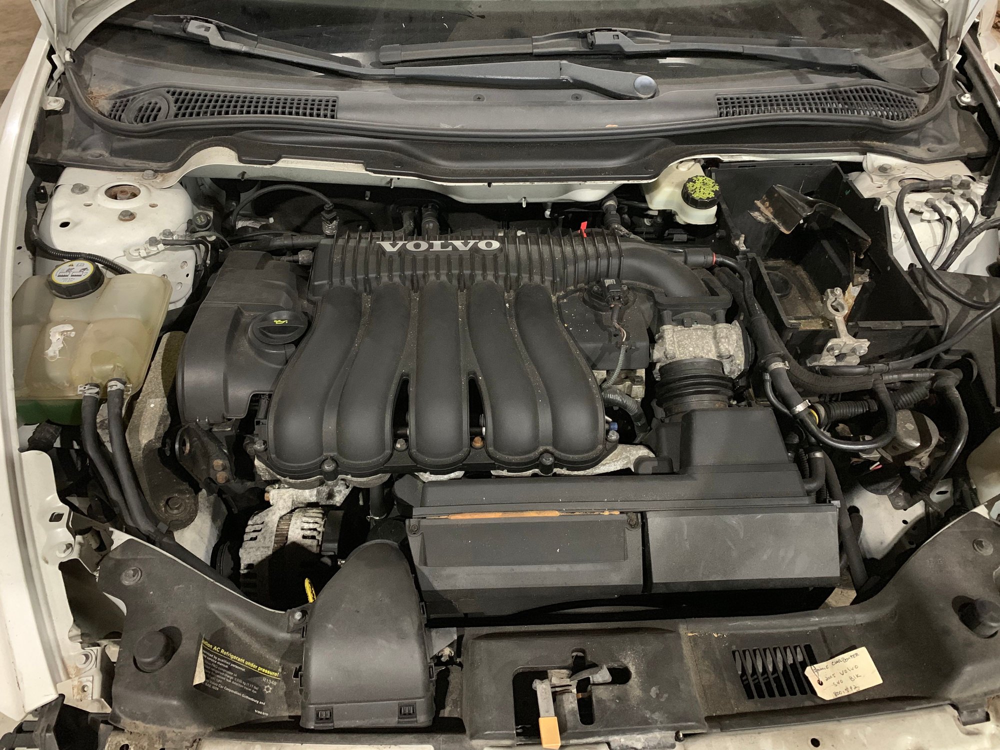

Look into auto auctions I bought mine from copart for a grand but had a bad engine at 170 thousand, I then bought a wrecked s40 from copart as well as a donor for my white 07 donor was an 09 s40 had just over hundred thousand miles I changed the engine, been driving it since June so far so good
