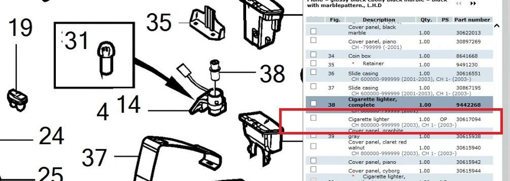

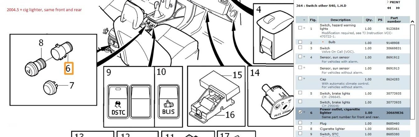

Early or late 2004? (two different cars) The 99-2004 parts may not be available anymore and Volvo lighters (after about 1998) are not anything like generic. Generic does not fit. Your best bet would be used or cleaning with a tiny wire brush or sandpaper on a stick.
Here's parts pages for both. If you have a 2004.5 there's a second lighter in the back of the console. And they are not generic either - google the part number from the page and you will see.
Early lighter ---
Late 2004 lighter ----

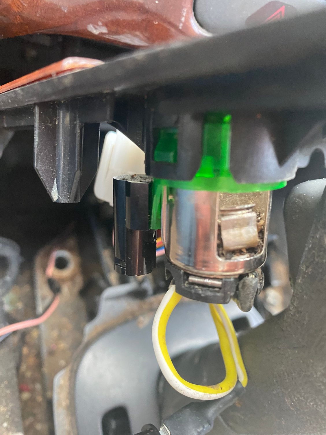

Actually the "ring" is the ridge on the socket. The socket is held in by tabs. See picture.
There are two wires, the yellow one is the hot lead. The tabs are difficult to release; I'm not sure if I should press on the top or the bottom of the blade. The black ground lead is not shown.
If I can free up these wires, I can leave the socket attached to the trim and get it out of the way of the removal of the retaining bracket for the shifter.
