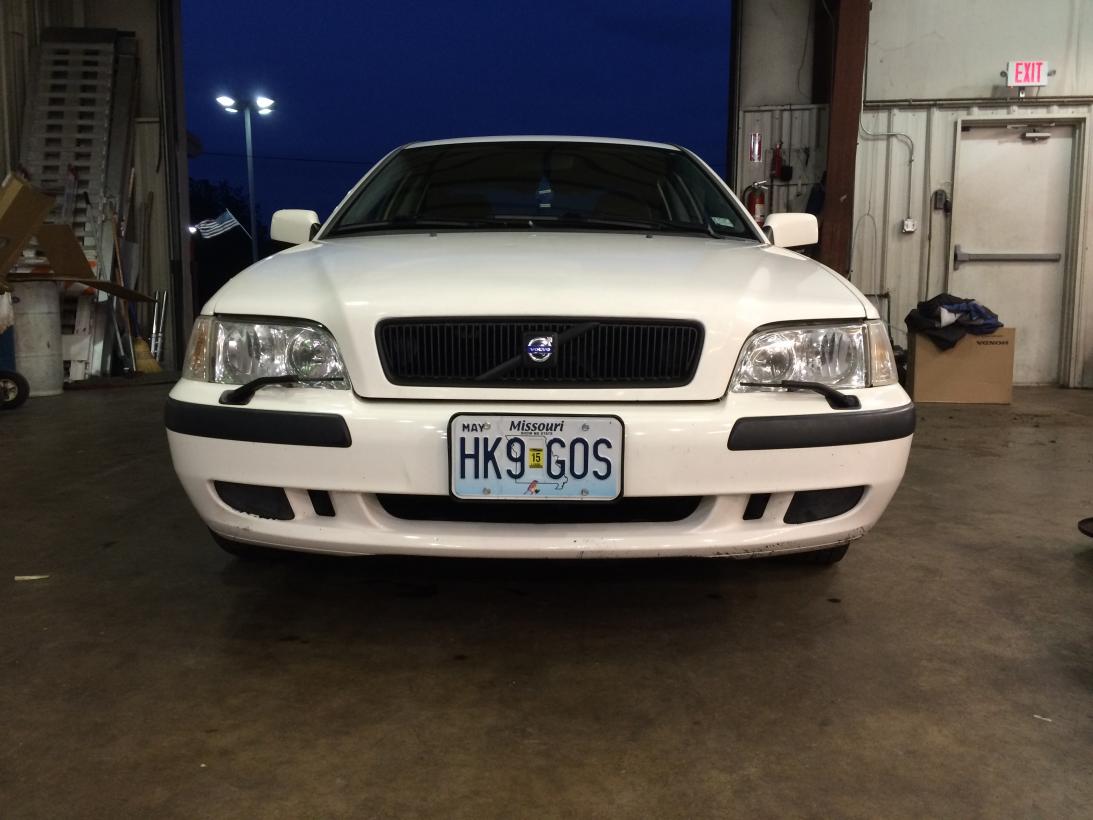

So, I decided to do a little experiment this past weekend and paint my chrome grill with "plasti-dip" or peel-coat. I think it turned out pretty awesome, it makes me want to pull off all my faded trim and have it professionally painted a matte black as well. However I do not want to damage the retainers when I remove the trim. Anyone know how that stuff comes off? Or will I need to take it to the body shop? Also, what do you think about the grill? (see attached)

Grill looks good. You not a fan of the fake peeling plasti-chrome?

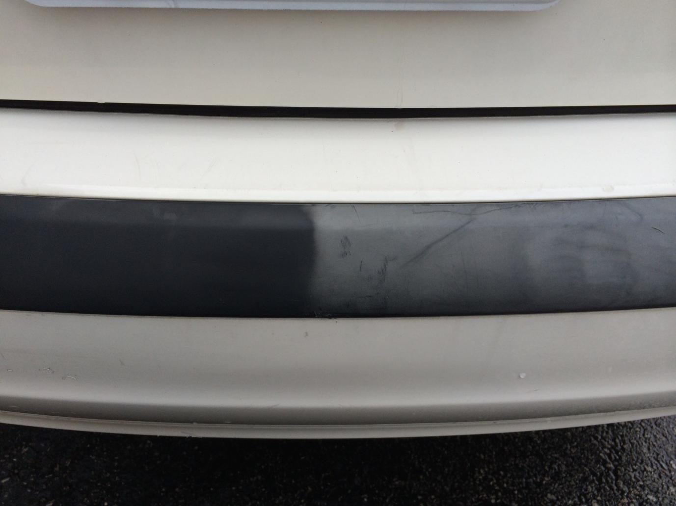

Interesting. I wonder if it stays flat after it cools.

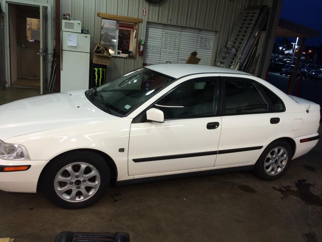

Alright, I finally had an opportunity to try the heat gun trick. I have to say, it turned out better than I could have hoped for. I started with the back bumper since its trim was in the worst shape of all the pieces. I even took a picture of the bumper when I was at the half way point to show a side by side comparison of the before and after. I even managed to get the windscreen garnish that sits under the wiper blades. Sorry it took so long for me to get around to it, I've been workin' 6 day weeks to keep up with the Aquatrax recalls.. got kinda crazy there for a bit. Anyway, let me know what you guys think, only took about 1.5hrs with the heat gun at 750deg/F.
