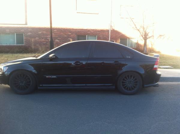

Hello all! My name is Tristan and I'm new to Volvo. Looking around for a sport sedan, has to be AWD, has to be a manual, and I prefer Turbos. Obviously then, the S40 T5 is hot on my radar. Found a nice used one on Craig's with a new engine and a few tasteful modifications. What should I be wary of when I go to view it? Obviously watch for engine lights and lurching and leaking oil and all that jazz, but what are some S40 T5 specific tidbits I should watch out for?

It's a 2006, 56k on new engine, doesn't show how many miles are on odo. I'll definitely figure all of that out (Why engine was replaced, did clutch go with it, how many miles on chassis, throwing codes, etc.). His mods listed are black painted wheels, window tint, coilovers, and a 3" cat-back exhaust.
I'll check for the timing chain as well. Nothing to watch out on the turbos or anything? (I only ask because I'm new to Turbos. I could talk superchargers all day, but turbos are new to me. I understand how they work and whatnot, just not what to be wary of on a used one.)
