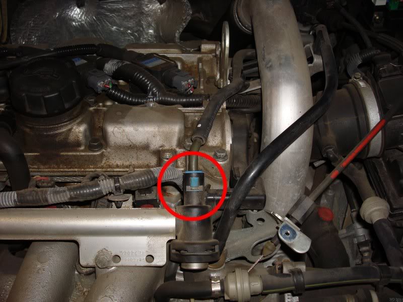

Hey everybody I am new to this forum and new to volvo. I just bought a 2001 volvo s40 1.9 T. I had it thoroughly checked out by two different mechanics and everything came back fine. It has 97,000 miles on it. So I just bought it last night and it drives like a dream. But when I went to start it this morning it cranked over tried to start, then died. I almost **** myself, I just paid 5000 for a car that doesnt work. So I tried cranking it over for another ten seconds and it wanted to start but wouldnt. So i finally tried again but started pumping the gas this time. It started up after ten seconds, revved to 1500, then died agian. Now I was really worried. So I tried again, but this time when i got it to start I held the gas down for about 2 seconds holding it at 2k rpm. Then I let off the gas and the thing idled down just fine and started running like a champ again. Does anyone know what this could be?! I am quite worried seeing how I just purchased the car, but it seems very odd cause it runs absolutely perfect, idles just right, no mis firing or fluttering idle. Please Help!!

Check out this post.
https://volvoforums.com/forum/volvo-s40-11/hard-starting-after-car-sits-long-time-40978/

Agreed. It was the fuel pressure regulator on mine too. The price has gone up though so be prepared for sticker shock.
