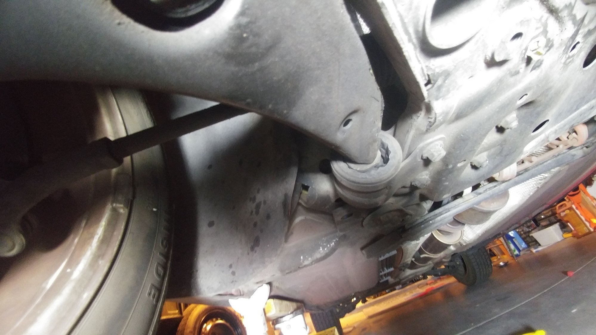

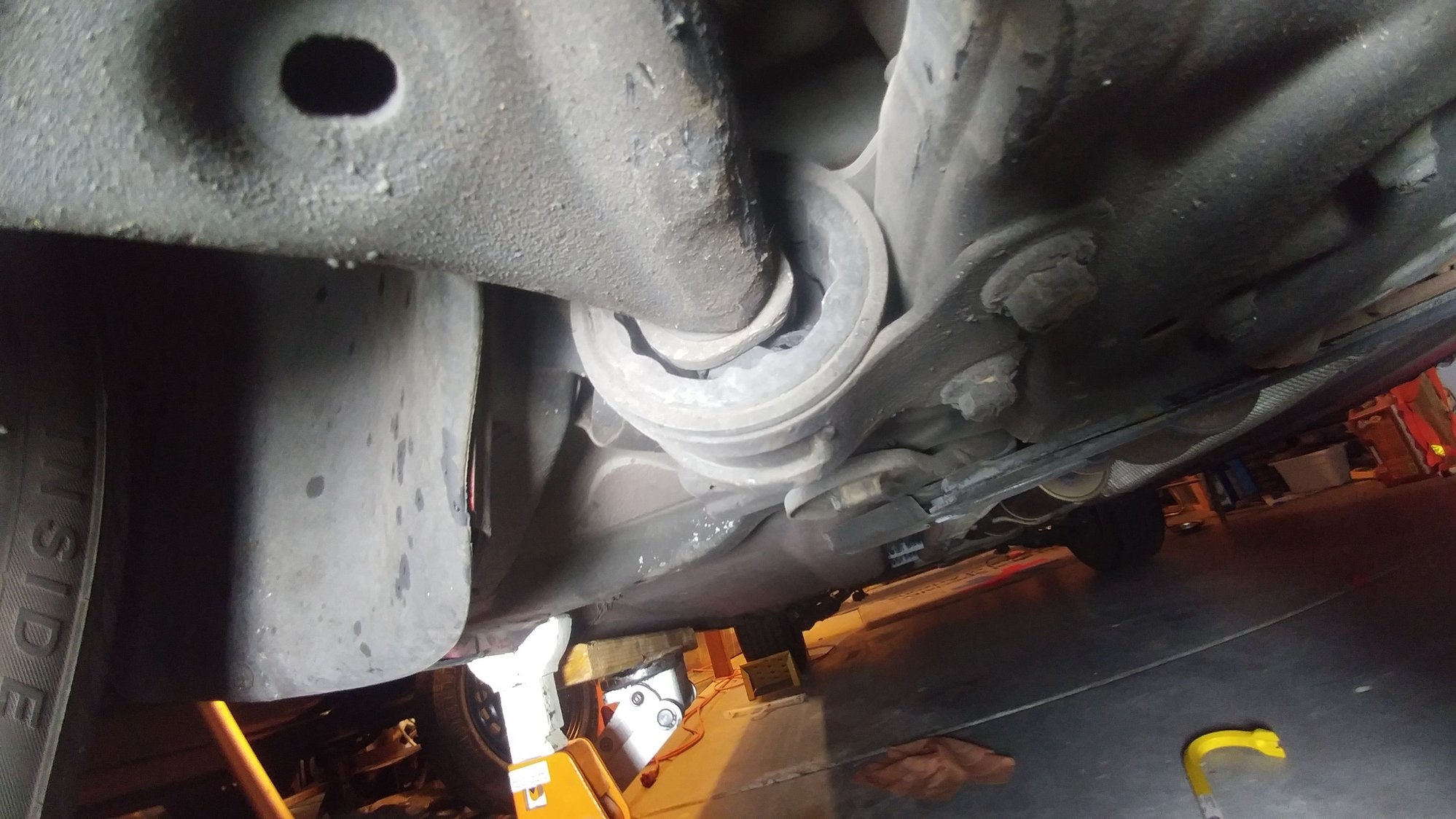

I jacked the car up and put it on axle stands (no load on the suspension) and tried to move all the suspension bits by pulling on the wheels and using a pry bar but i couldn't move anything sufficiently to make a clunk.
I put the car on ramps so the weight was on the wheels (suspension under load) and tried bouncing the car and again tried with the pry bar but i cannot move anything enough to make the sound.
nothing appears to be loose.
the only part that looks suspect is the rear bushing on the control arm (thanks Habbyguy for that suggestion).
On axle stands so no load on the suspension
On axle stands so no load on the suspension. I would assume it should be closer to the middle. The rubber in the middle looks a little torn.

They sure look like toast to me, though the camera angle can play tricks. FWIW, I'd suggest replacing the control arms, which include the bushings and ball joint - saves a lot of hassle and time, and they're really not all that spendy.

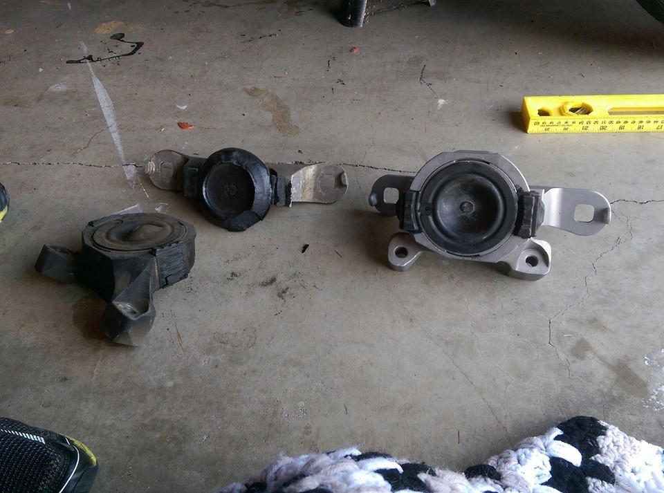

When mine had a clunk it was the pax side upper motor mount. The rubber had split in two.

If your car is like mine, braking very gently won't make anything clunk, but hitting the brakes fairly hard will produce a very noticeable, sharp response that you can feel in the steering wheel, with a slightly muted metallic sound from the front end.
If there's absolutely zero sensation through the steering wheel when the clunk happens, it could be a motor mount, though that should be easy enough to check by watching the engine rotate when the car is shifted through R-N-D and back. It'll rotate a little with new mounts, of course, but movement should be pretty obviously excessive with a mount like the one in the previous post (yikes...). ;-)
