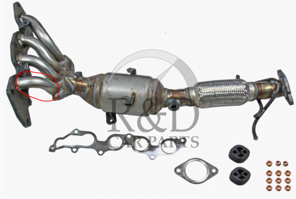

As I understood, it should be this (sorry for the random image, I tried to circle it with a snipping tool):

Yes, you do want to replace that manifold / cat converter. And yes, that can cause the problems you're having, since the crack will cause very inaccurate readings at the upstream O2 sensor (also known as the fuel-air sensor since it allows the engine management computer to set the amount of fuel based on the sensor's analysis of the exhaust gasses).

Ah yes, I did not realize this was one piece on this car. +1 to what habbyguy above me said
