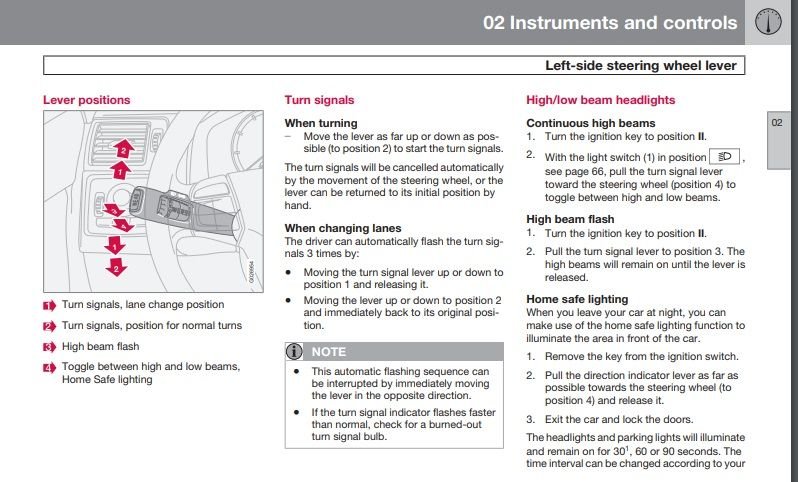

There's 2 functions pulling back the turn signal switch. 1st position flash high beams, 2nd position switch to high (or low) (labeled 3 and 4 in the diagram)
