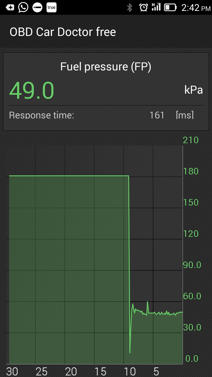

Hello friends
I have s40 2006
After a 30-minute car drive I feel intermittently fuel for the engine and I can't be tread gasoline tread
Can anyone tell me what are the problem
Attached Thumbnails Volvo s40 code p0089 p0172-screenshot_2015-09-03-15-35-32.jpeg   Volvo s40 code p0089 p0172-screenshot_2015-09-04-14-42-40.jpeg

The newer S40's have a fuel pressure sensor (NOT a fuel pressure regulator like the older models). When this goes bad you will get a loss in power. The new Volvos use voltage to vary pressure from the pump.
It's located on the passenger side of the fuel rail.
