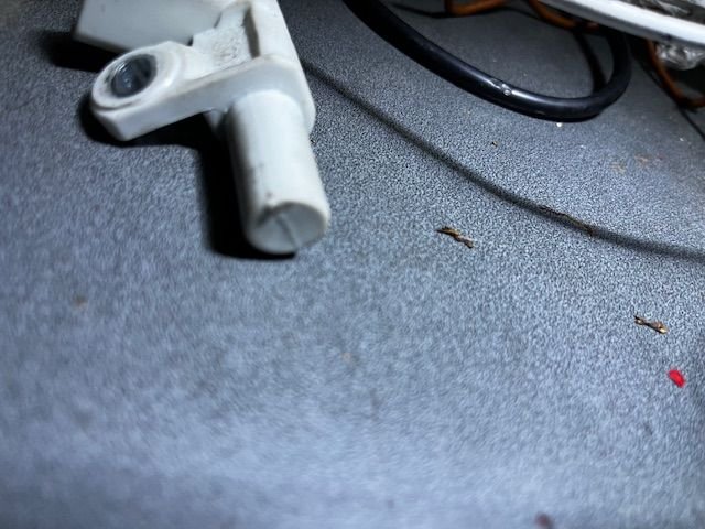

frenchcon's Avatar
Joined: Sep 2012
Default Hard start update
Originally Posted by JoaoS40
Everything you replaced i already changed.
The only thing missing in my case is the throttle body. But i didn't check the signal sent by the ECU to the injectors.
Unless your throttle body is closed when your engine is off, (easy check), then it wouldn't be the probem.
Mine was a bit sticky when I closed it manually, but after cleaning was fine.
What I am finding is my starter motor isn't cranking the engine fast enough, even though it is recent, and I took it apart, tested it with ohmmeter, and cleaned it.
I did gain some rpms, but it is still around 250 rpms, with new battery fully charged. As I have commented, the SID803 ECM has a cranking threshhold of around 350 rmps before turning on fuel injector ouput stage (at least for Citroen), so I might be off a bit.
I think my problem is the starter that is currently installed is a 1.2Kw (no references on starter), so I am guessing, given the results.
I have ordered a 2.2Kw starter motor, which should bring up the cranking rpms and help with starting.
What I did find as was that the cam sensor that I replaced has a little calibrated plastic protrusion at the end of the sensor. This allows you to install it in position until it touches the cam gear, and then tighten in place. This is how you know the sensor is at the correct distance (1,5mm +/- 0.5mm). When you crank the engine, the plastic protrusion will break off.
When I took apart my sensor, the plastic was still in place. meaning I did not install correctly.
After readjusting, I noticed a big improvement with the hard start problem.
I think once I replace starter motor with a higher power, hoping my wooes will be over.
I will update, once new starter is in place.
