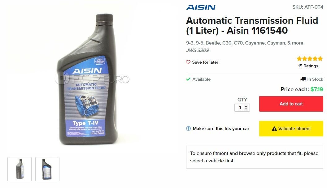

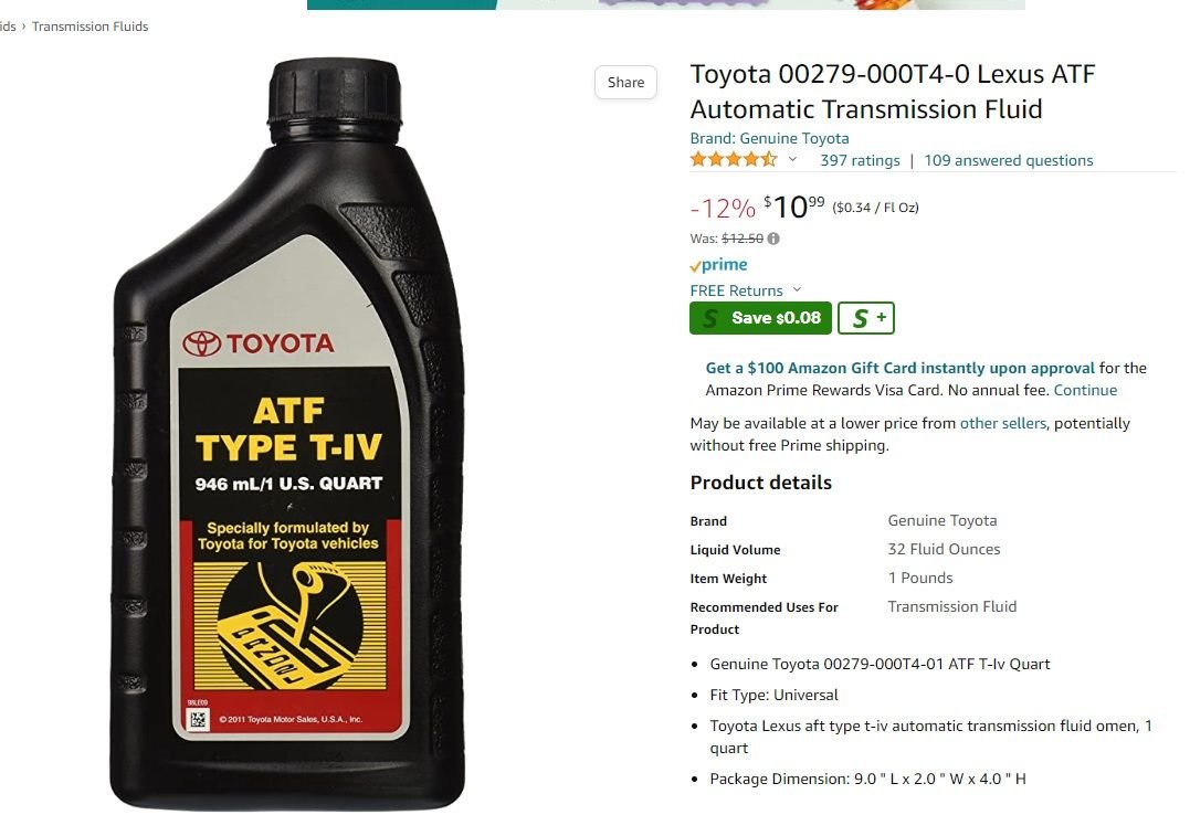

1. JWS3309 spec fluid ONLY. Pictures of a couple of choices below - or the Volvo brand fluid that is more expensive. (Aisin is the transmission manufacturer, and 1161540 is the Volvo part number if you want to search for the Volvo fluid)

fluid should be easy to find = Your Volvo has a a 5 speed Aisin transmission - same as Toyota and Lexus (which is why hoonk showed you the Toyota T-IV fluid) so its a pretty popular model and Toyota doesn't jack up prices on fluids. You can read the labels on the bottle to confirm which specs the product meets. For the most part, Volvos of that era either used JWS 3309 or Dex III. They are not interchangeable since they have different viscosities so make sure you get the right one. And +1 on NOT using transmission additives. Again those products will alter the fluid's viscosity and tensile strength. The transmission relies on a set amount of friction from the fluid to operate. Wrong fluid can cause or speed internal wear.
