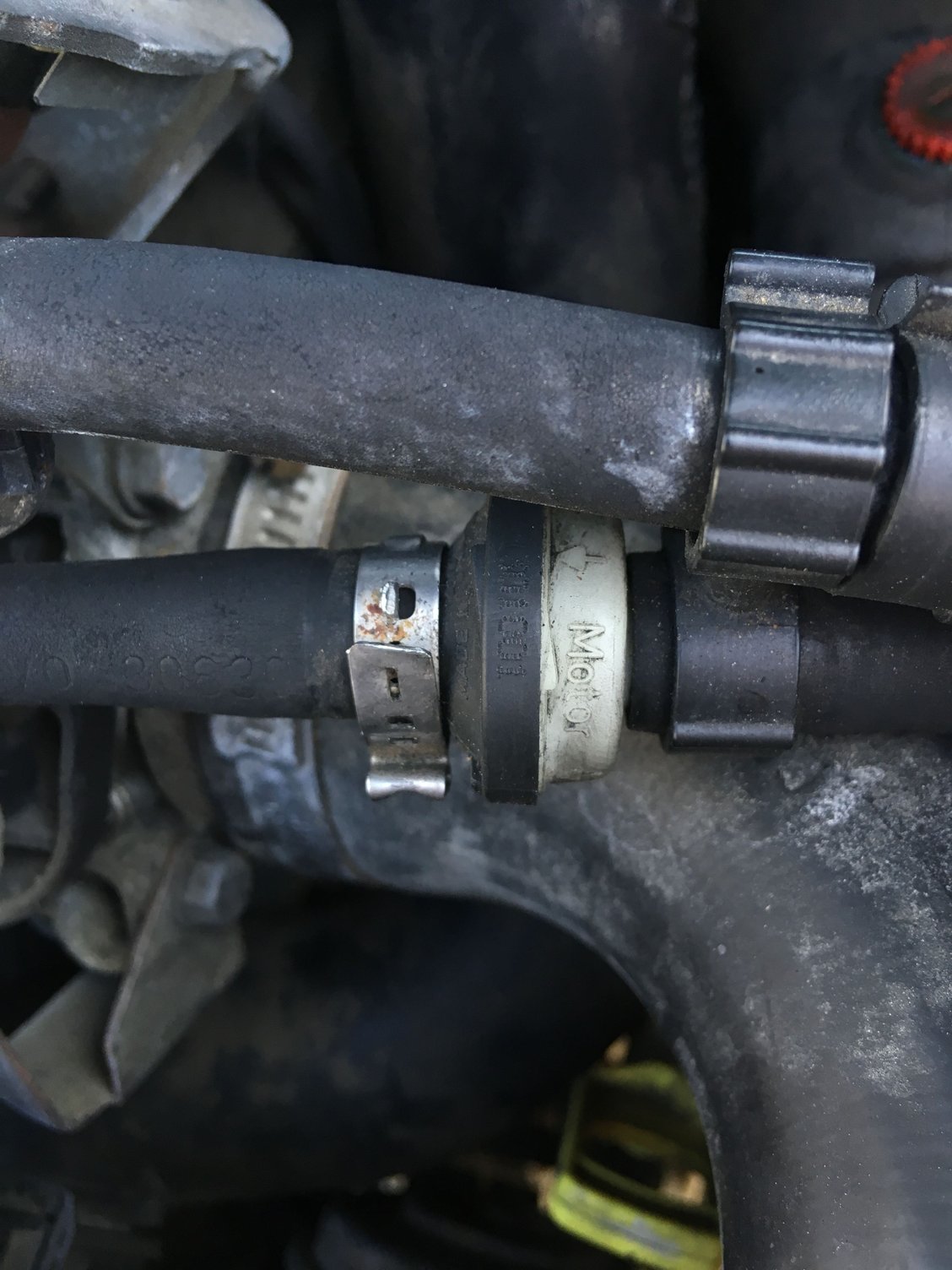

This is the disk thing that I am talking about

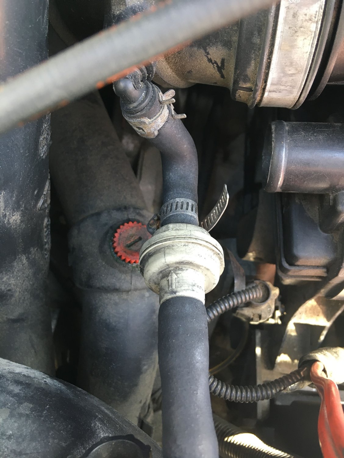

This is a hose that runs right over the throttle body

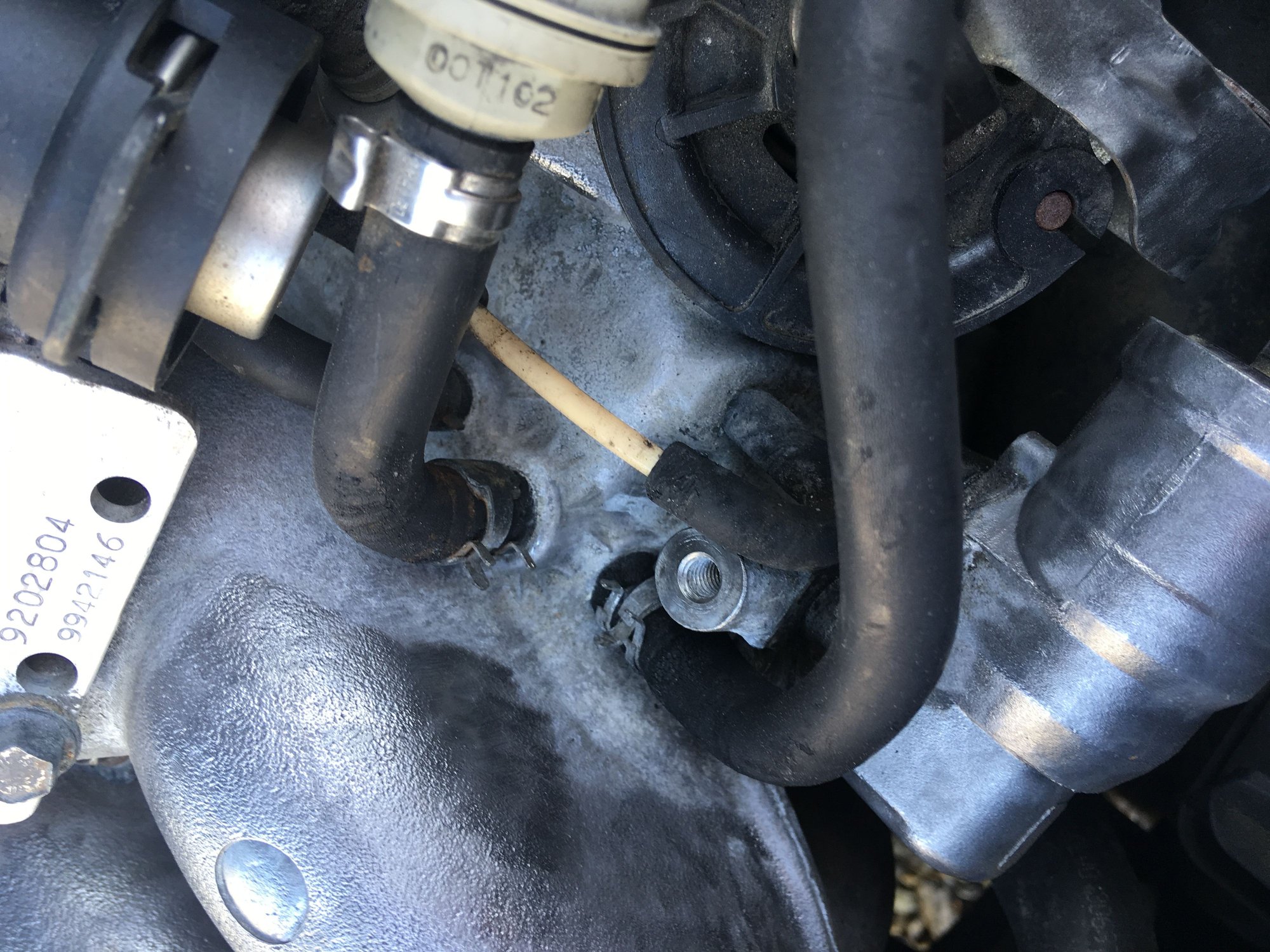

These are the two hoses that I can unplug to make my car idle a lot better, if I unplug either one it idles at like 1,400 rpm, but if I unplug both then it goes up and down between 2,000 and 2,500 rpm.

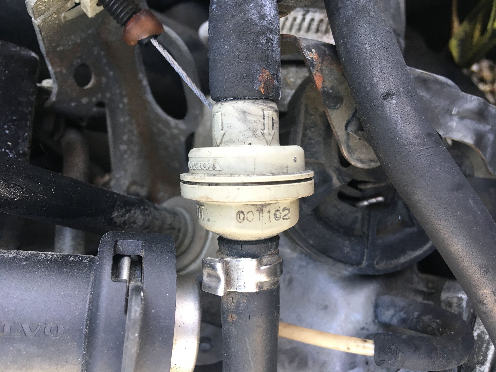

This is another disk thing that goes from the air intake tube to the throttle body

You probably have a very dirty throttle body. When you pull off a hose, more air enters the engine and it smooths out the idle.
Start by removing the throttle body and cleaning both sides including the edge of the blades.
The base program assumes a certain amount of minimum airflow and that's why your idle is so bad.
