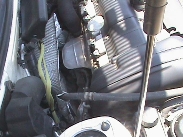

If you are standing with hood up and facing the car from the front.
Lean over the engine, look around back.
Heat shield, now stare at it, move about 90 degrees to the passenger side of the car.
Behold, the tiny turbo. All models from 2000->2004.5 were 1.9T 5spd auto's, though there are a few on the forum who converted to manual. This only applies to North American S40 imports though.

Here are pictures, sorry they are bad quality, ground was 138 degrees since it's baking in this TX sun and i had no shoes.
Attached Thumbnails Where is the turbo located on my 2003 volvo s40-dsc01378.jpg   Where is the turbo located on my 2003 volvo s40-dsc01380.jpg
