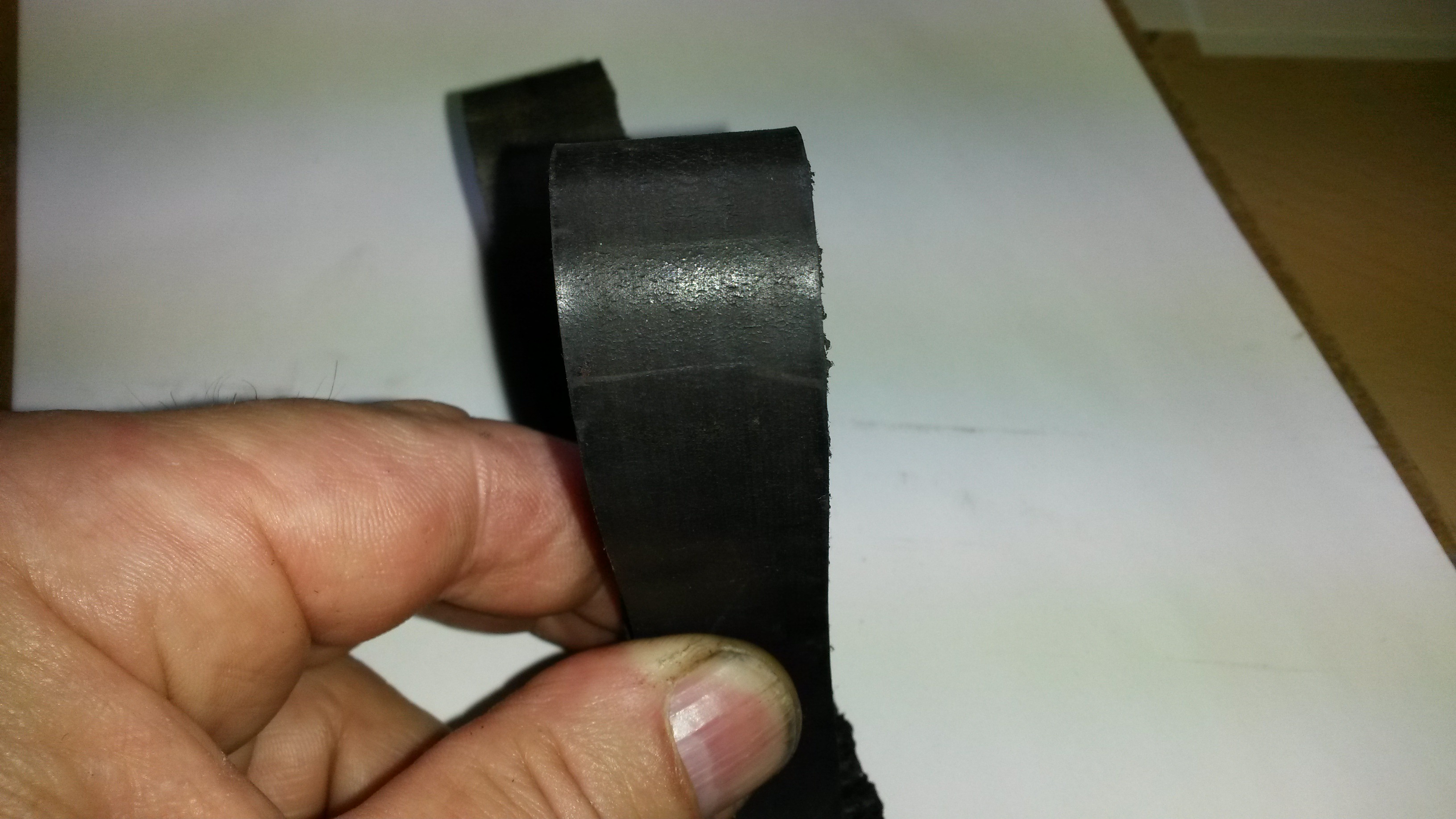

I just changed timing belt kit and serpentine belt in my 03 S60 T5 with 181k kms. I bought it used with 135k and don't know if timing belt has been changed - I assume it was not, because Volvo recommends changing timing belt after 170k. Well as you can see the belt looked very good, almost like new. It was an original Volvo belt.
Also I found that a new tensioner was little different than original - as you can see, well...I put it in anyway, set tension in the middle ( It was about 20C), tightened and works OK. Also serpentine belt looked like new but, I changed it anyway.
