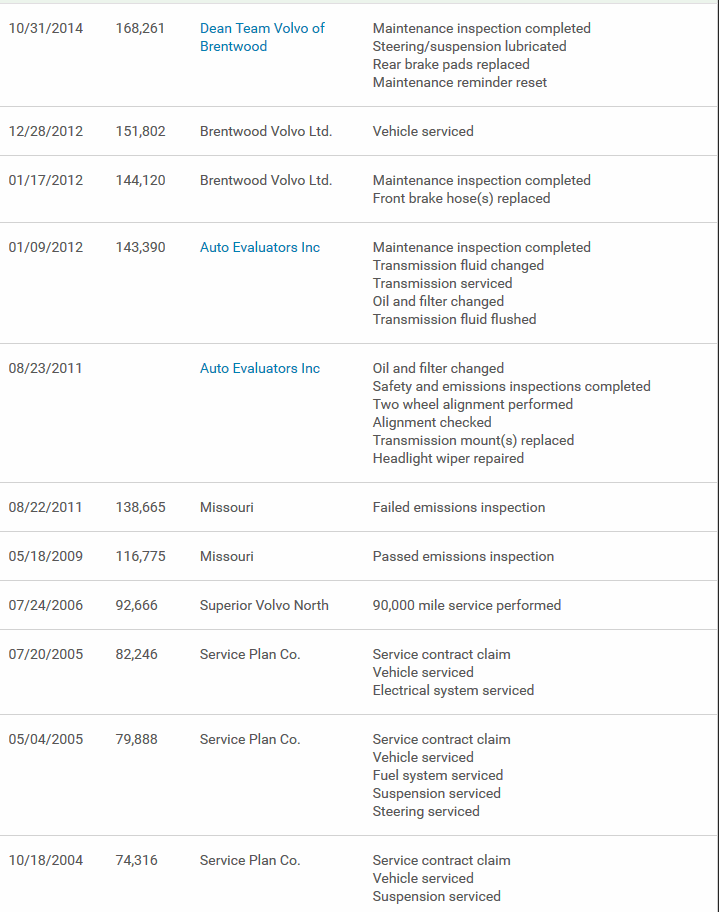

Any thoughts would be greatly appreciated. I was told the car was well maintained. I have included the history I was able to find online.
Attached Thumbnails 2001 Volvo V70 T5 Auto "No oil pressure"-volvo-1.gif   2001 Volvo V70 T5 Auto "No oil pressure"-volvo-2.gif
