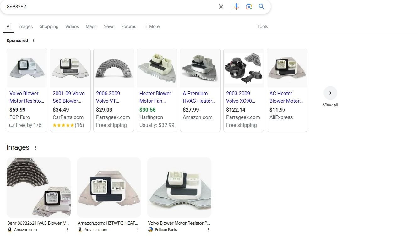

I did some research and others have found the fan driver to be at fault. However, some have reported that their mechanic changed their 'regulator' which may be the same thing by a different name given that I don't see anything else in the circuit. Looks like the CCM send a PWM signal to a driver module which outputs to the fan...so what is the regulator?
Seems like I need one of these modules? Anyone have another idea?
Yes, that would be a common fix for your problem

Yup fixed!
1/4” drive t25 with a long extension and a universal helps to get the fan out
video by “peppermint” is excellent
