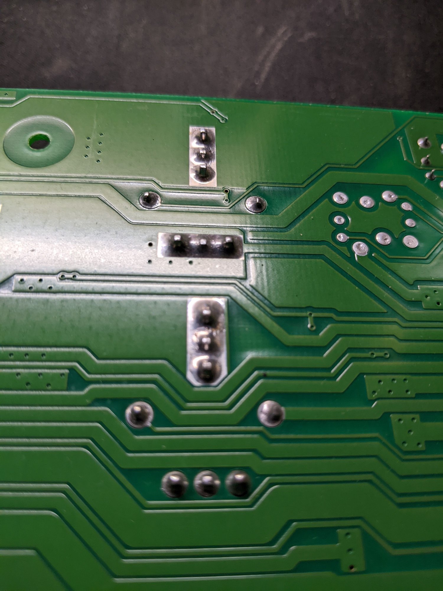

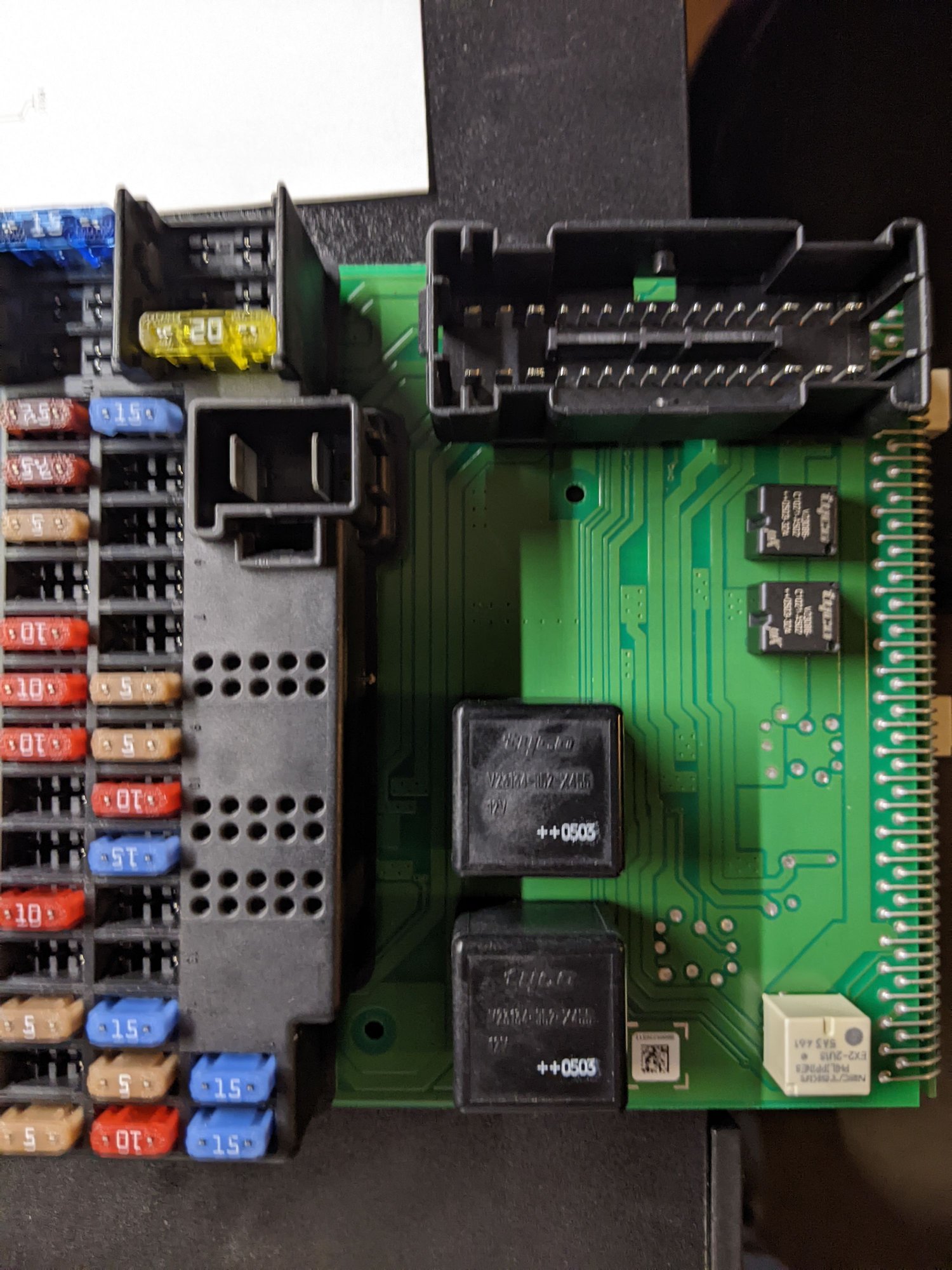

Pics show the relays and their solder points. (Sorry, I don't know how to resize to smaller)
The Tyco part number is obsolete. (V23134-J52-X455)
Does anyone know the current replacement part number and U.S. supplier?
Cover removed showing relays
Each relay is 4 pins - 2 on each are split into 3 solder pins to handle the load

SOLVED!
The image on the page was throwing me off. It's a generic image to show relays in general.
The CAD files have a 3D pdf showing this is the needed relay for the 05-09 CEM
