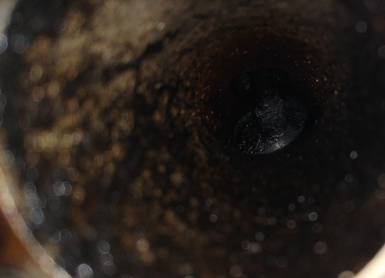

Crack developed at the fitting.
Cheap non-heat resistant plastic, disappointing for a 2015 vehicle I ve had since new.
To replace that hose(it is very rigid) entire intake manifold and water pump have to come out.
New one was identical materials and build, so beware.
Also, valves had a bit of oil/carbon buildup, see pics, any input on that appreciated.
