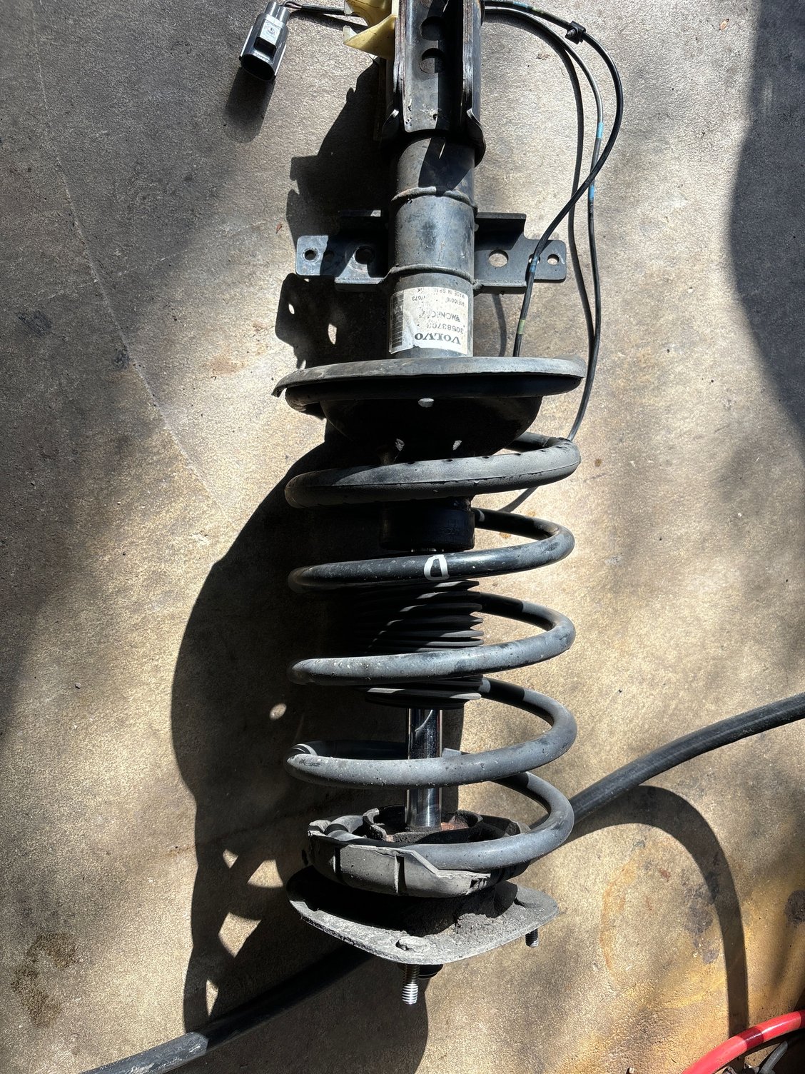

looking for a little help on front strut replacement on the 4C. I just started tackling this and got bewildered on why there are no bump stops? These appear to be the original struts. The bellows were completely collapsed but when I got everything taken apart there are no bump stops to be found on either strut from the front. Are they supposed to have them? My reason for questioning is that everything I’ve read says yes but they are completely non existent on both of these. Any help is much appreciated before I put it all back together “missing” a piece.
Not taken apart yet.

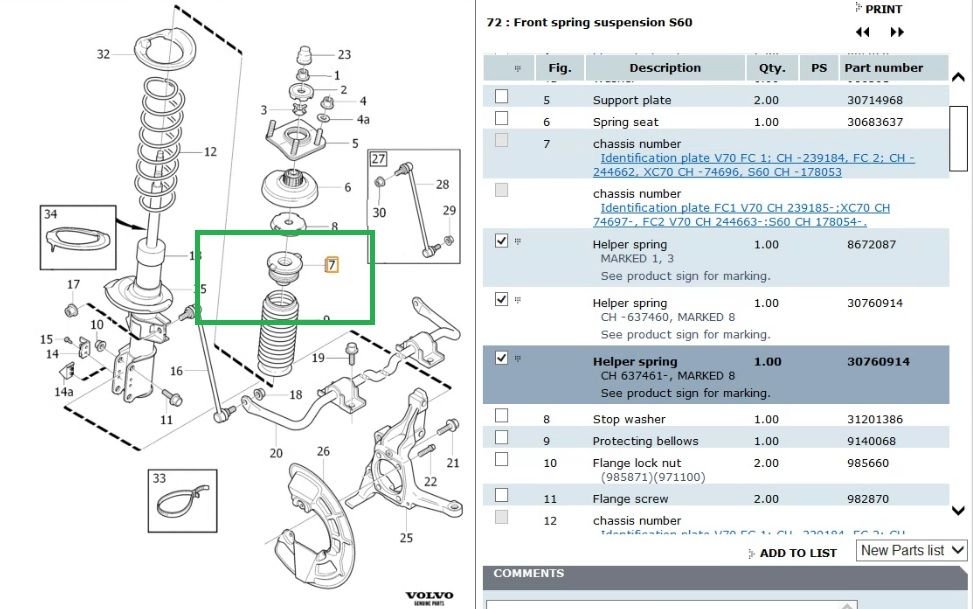

The bumps stops are a foam material that degrades and disappears - appear to be two different choices depending on variables -
