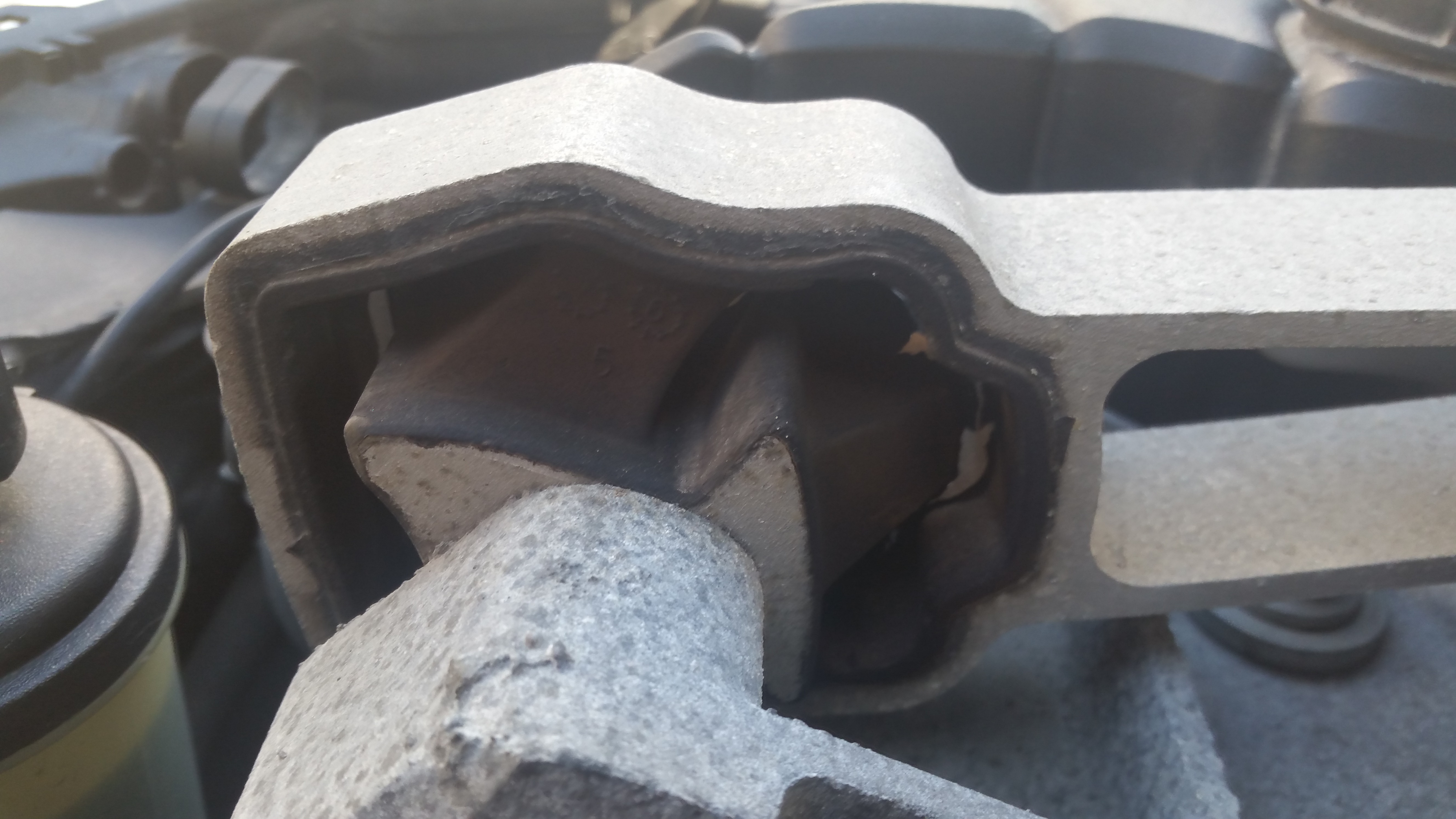

Need some help in making a decision, 2013 s60 torque rod mount rubber is broke away from 70 % but the 2 main rubber mount are still attached. ..the rubber that is broke away just looks like the way the mount is built and serves no purpose. So is the mount broke..thanks

It is not broken, that is how it is supposed to be.

Thanks for the quick response but I seem to be getting more Torque steering then normal . Any ideas

I always thought of the torque rod as a vibration damper and not a device that decreases torque steer under acceleration. If you're getting torque steer when accelerating is your dynamic stability control disabled?
