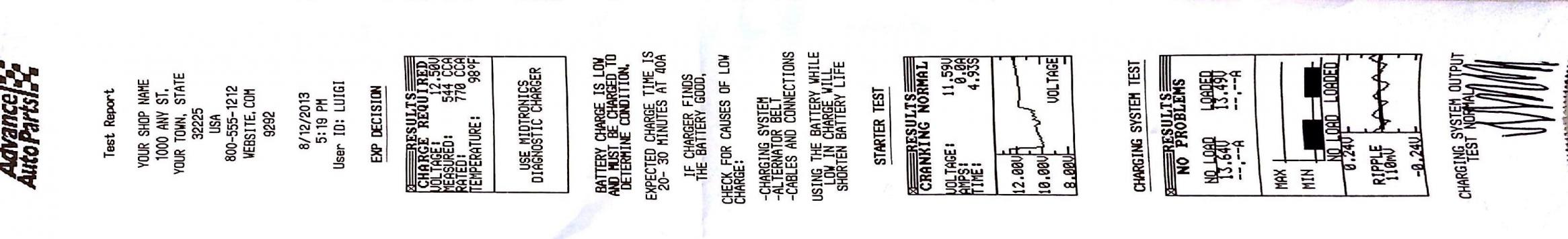

Went to Advance Auto Parts and they ran a battery test, starter test and charging system test. Scanned image of test results is attached.
The charging test says "NO PROBLEMS" as well as "CHARGING SYSTEM OUTPUT TEST NORMAL". However, the Advance Auto parts guy pointed out that he thought the RIPPLE graph was too bumpy and may indicate an alternator issue.
So what do you guys think? Two years for now two batteries is not very long.

Shouldnt your alternator be putting out about 14.5 volts to keep the battery topped up.
Volvo's and their electronics/computer etc place high demands on the battery.
Check the alternators output with a multimeter.
