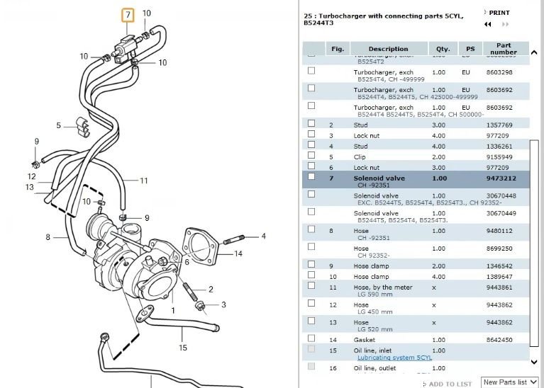

#7 solenoid controls boost pressure - my techs have replaced a few, but not sure what other parameters might cause the valve to go to high or low. Or if the valve itself is simply sticking.
I have replaced this solenoid 3x in 2 years on my 06 S60 (granted it was running 12psi instead of stock) and other P2 owners replaced them a lot too. I think they run about $30 on fcp. Search Turbo Control Valve or by part # that hoonk provided.
I have also seen a lot of people install an inline air filter on the line coming from the turbo compressor. This will help keep it clean from oil vapors which can cause it to fail prematurely.
