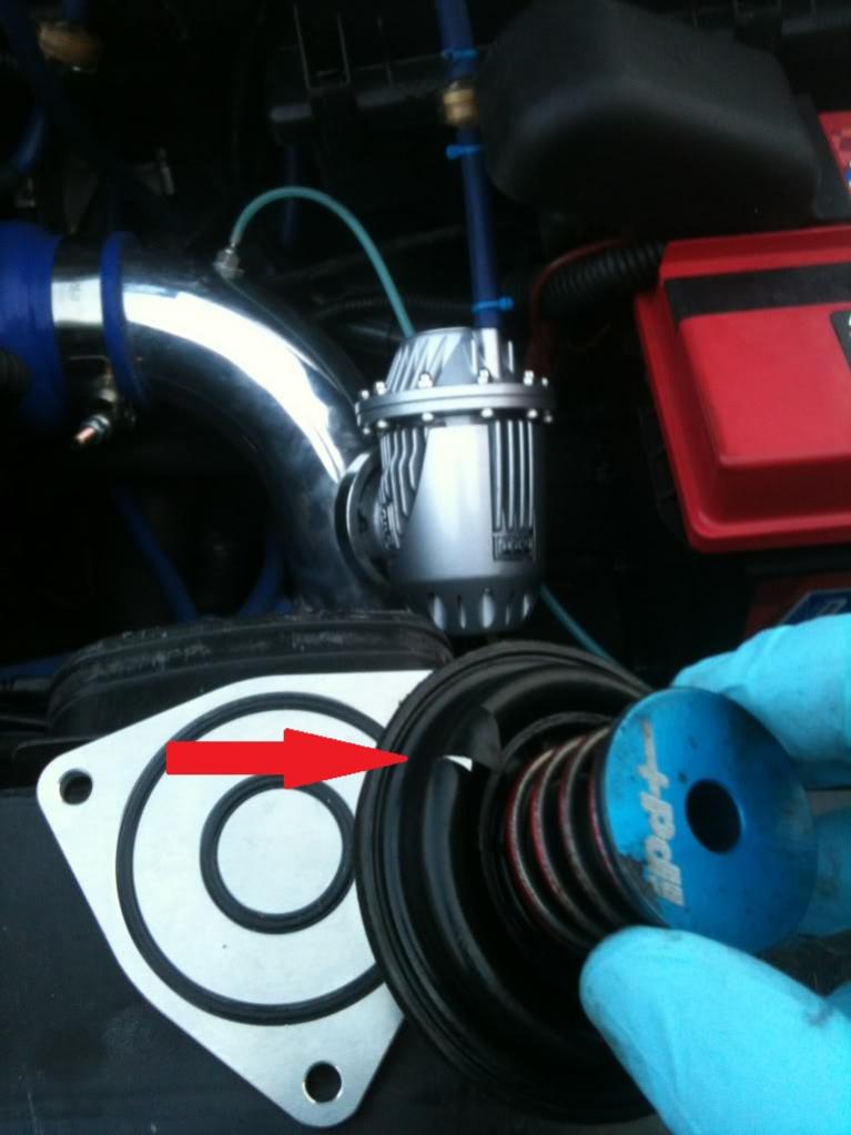

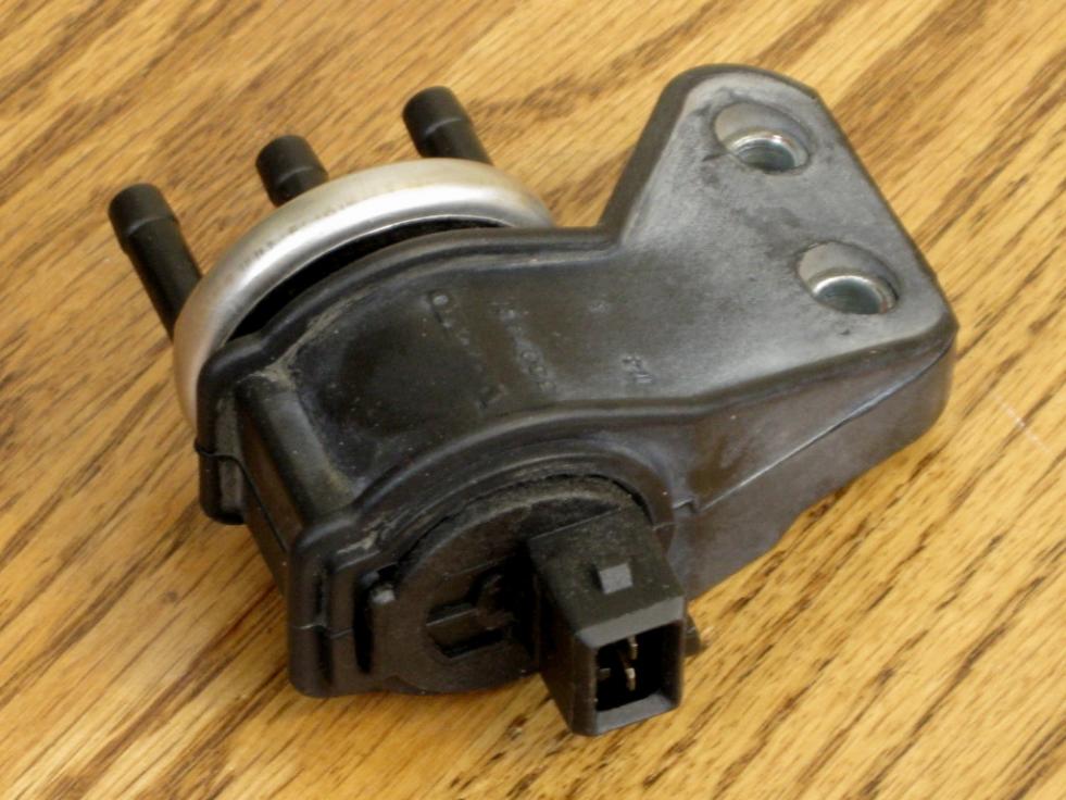

Maybe a ripped diaphragm ?? Or a malfunctioning BCS that's sticking ??
Attached Thumbnails Erratic boost issue-turbo-bypass-valve-ripped.jpg   Erratic boost issue-turbo-boost-control-solenoid.jpg

is there a way to test the diaphragm while on the car? i dont have access to tools while at school
Old Aug 28, 2013 | 08:40 PM
97black850's Avatar
Joined: Sep 2011
Posts: 416
From: Pittsburgh
in all honesty, i am going to try and replace both the cbv diaphragm and tcv considering there probably original considering the vacuum lines were
