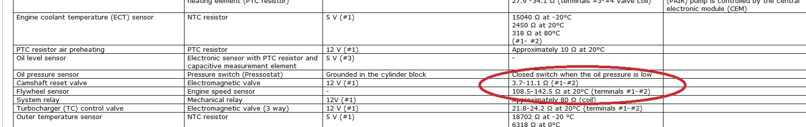

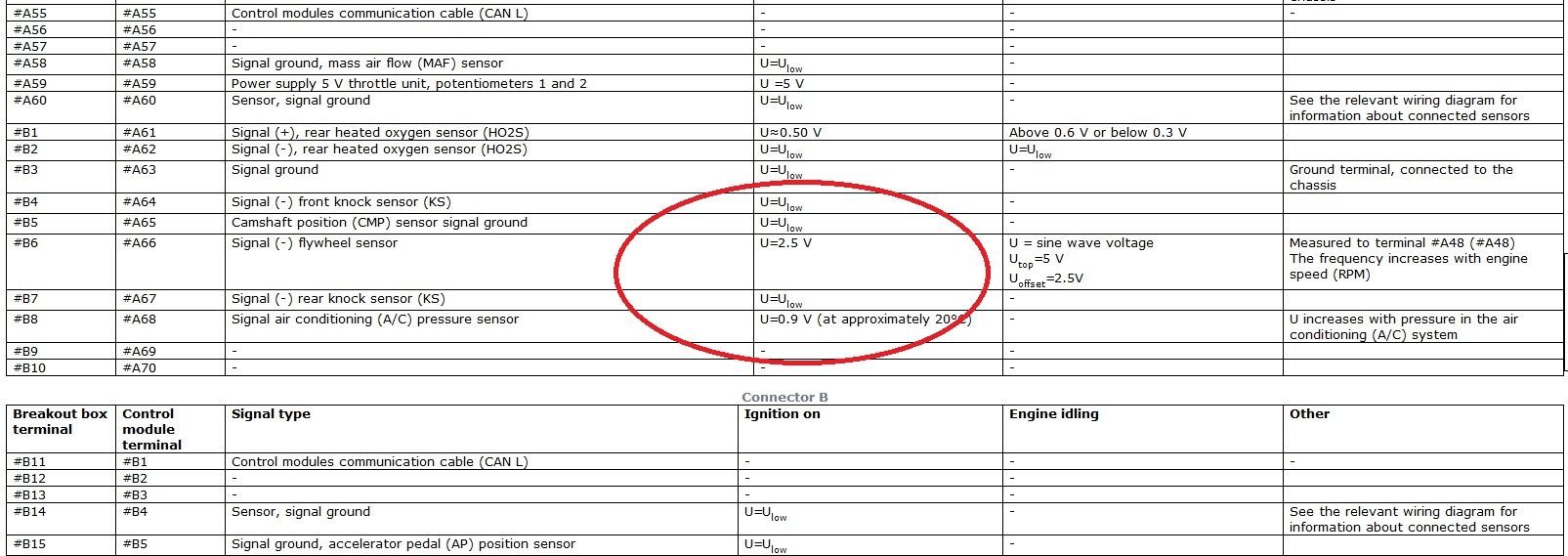

Are you messing with this part?
If so here's info - I would check resistance and if it's ok - move onto another theory. Engine speed sensors were a common failure on the red block cars. So with that experience all my techs would say they were bad on the 1991+ aluminum block cars when they could not figure out what the real problem was. (bad air mass meters have always been a wrong diagnosis also!) So - I had two of them in stock (since they did not fix the problem, the old ones went back in) and on the shelf for many xx years when I sold 4 years ago. I can say my shop has never seen a bad engine speed sensor on a 1991 + aluminum block car. I'm in the south not subject to corrosion and that may be why. Yes they changed part numbers in the 2000's. So it's possible. Another possibility (if it's really crank position sensor related) is a damaged flywheel/ring gear. Usually caused by a foreign object in the bell housing (usually an errant bolt). Normally that damages the speed sensor itself. Have seen that a few times.

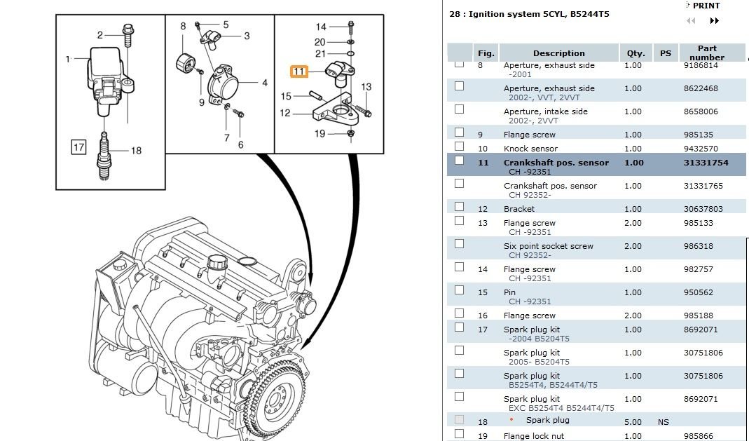

thank you for your narrative and the pics. Yes, part #11 is what I'm dealing with. Is that info stating the voltage to ground on EACH lead coming from wherever, going to the crank sensor is 2.5 volts? I'm seeing 2.4 from EACH lead to ground (measured with multi tester and not sine wave instrument), ignition on, engine off. I assume 2.4 is close enough. So......if the crank sensor is good, voltage to it is good and if you read through the thread with what I've already written, where should I go next in determining the root cause of the hard and no start condition.
