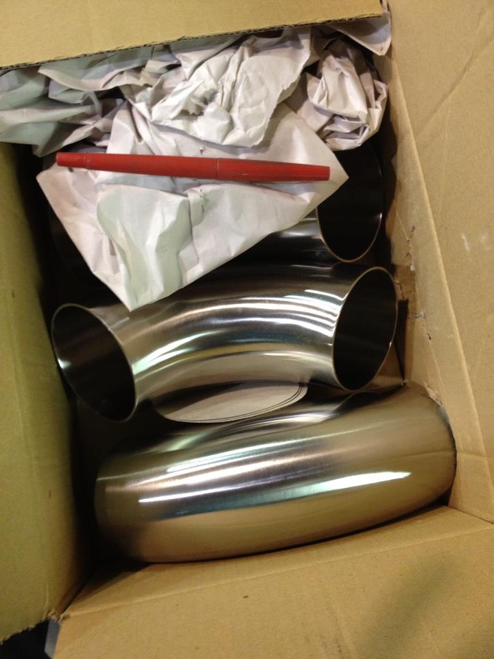

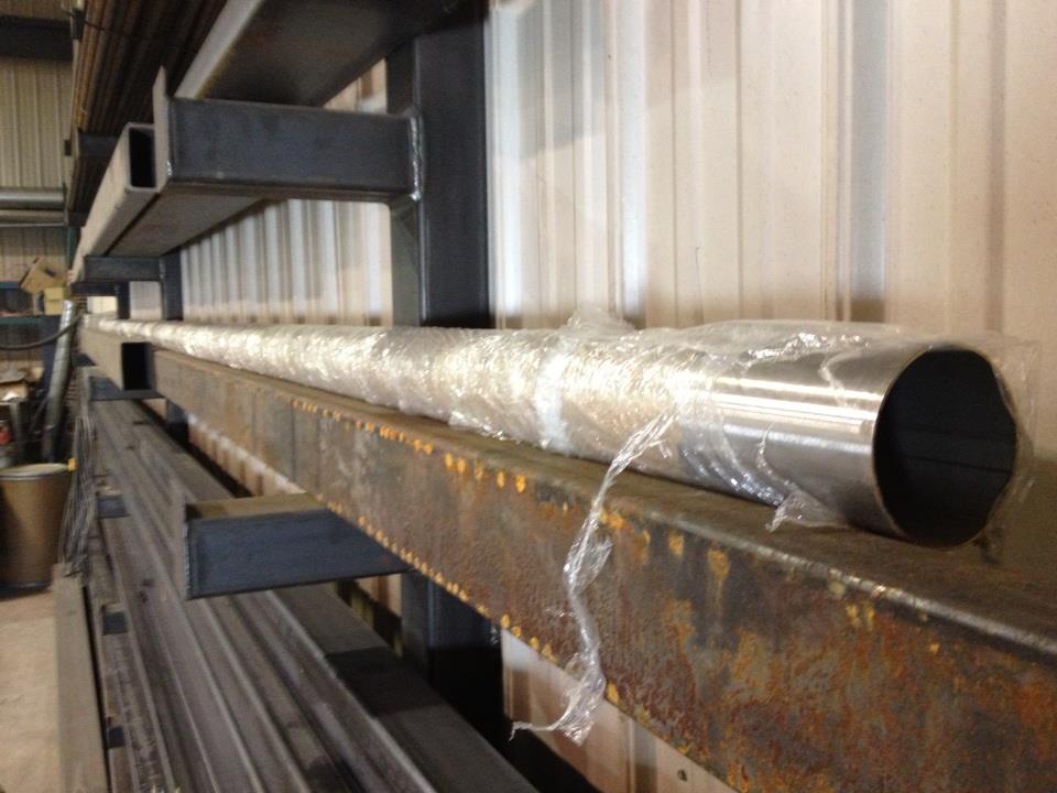

So why not building my own exhaust? I bought 3" SS304 pipe with res and Magnaflow muffler.

Angles instead of bending and restrict air with this it's 3" all the way.

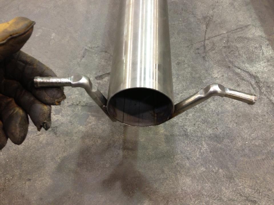

Reused my Heico exhaust tip it's nice so just cut and bent a little part of the pipe and weld well it works perfectly
