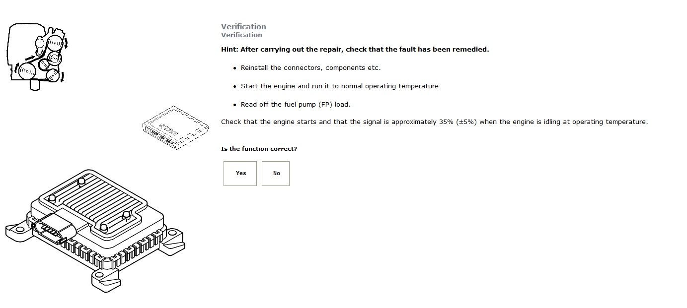

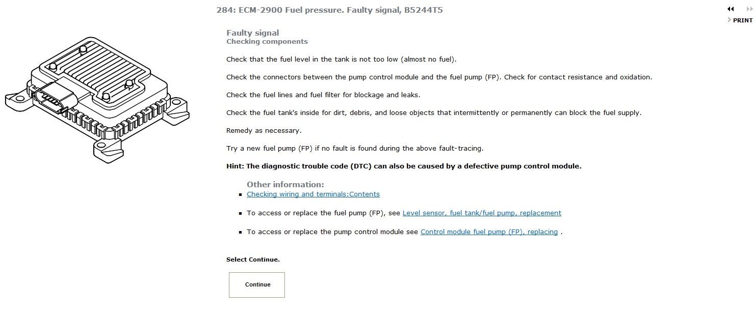

For a ECM 2900 - I have seen the fuel pump load percentage be too high - and unfortunately a new fuel pump solves that. Vida's procedure (posted below) is to verify the pressure sensor is sending the correct signal using a fuel pressure gauge, check fuel delivery (filter, leaks, etc), then "try a new pump". But before that read off the fuel pump load as in the last slide - If it's more than the recommended 40% the fuel pump is weak. I have replaced many bad fuel pumps, but the only controllers I replaced were due to corrosion, when they were mounted to the outside of the gas tank (great design!) BTW - this info is in VIDA - A stolen/hacked copy is easily found on the www. Swedespeed has a copy in their OBD forum.

a little update if interested: I replaced the pump today and the pump load went from 55% before to 35% after. Guessing my pump was going out after all. Thanks for the help
