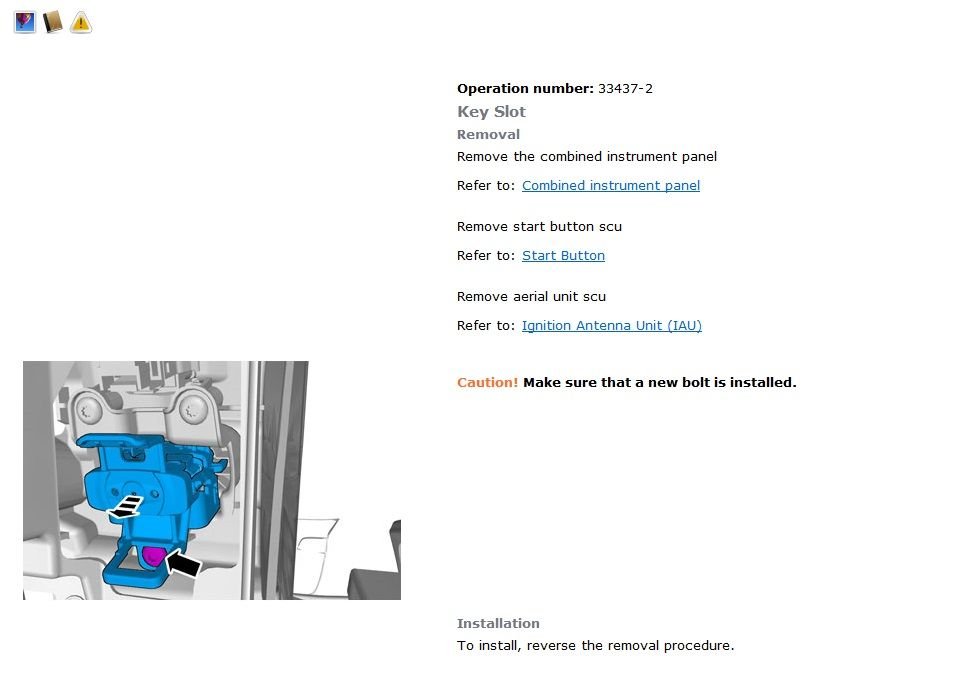

Originally Posted by JazRay57
Has anyone successfully replaced their plastic engine start bezel switch?
Sure - take the instrument cluster out, plastic trim at the bottom pops up and 4 torx screw, push the start button out from the back, remove the antenna and key slot, then you can remove the bezel. Just a few minutes to get to it.
