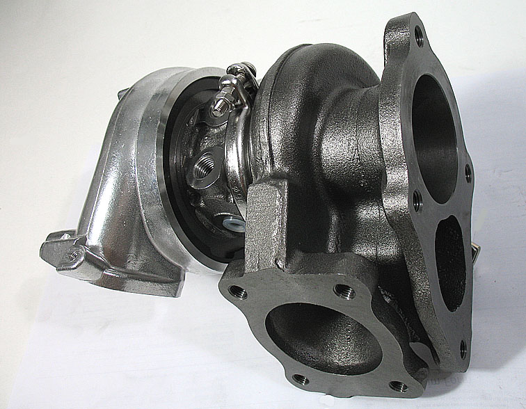

hey i was looking around and everyone talks about swapping the 13g turbo to say the 16/18/19t...which if i looked it up right it is a TD04 family...i used to be into DSM talon/eclipse and know they also use the TD04 series compressors. i found the jdm TD04 16g today for 200 on ebay ... will this turbo be the same as say the 16T and bolt up all around from exh. manifold to turbo ...turbo to downpipe, all oil/water lines? here the link: http://cgi.ebay.com/ebaymotors/JDMS-...Q5fAccessories

That one in the link is a TD05H-16G you need a TD04HL-16T, like this.
I would stick with the volvo models. Make sure that it is a straight flange and not the angel flange.
The TD05H has a different compressor set up than the TD04HL. You would have to machine the exhaust manifold to make it work.
