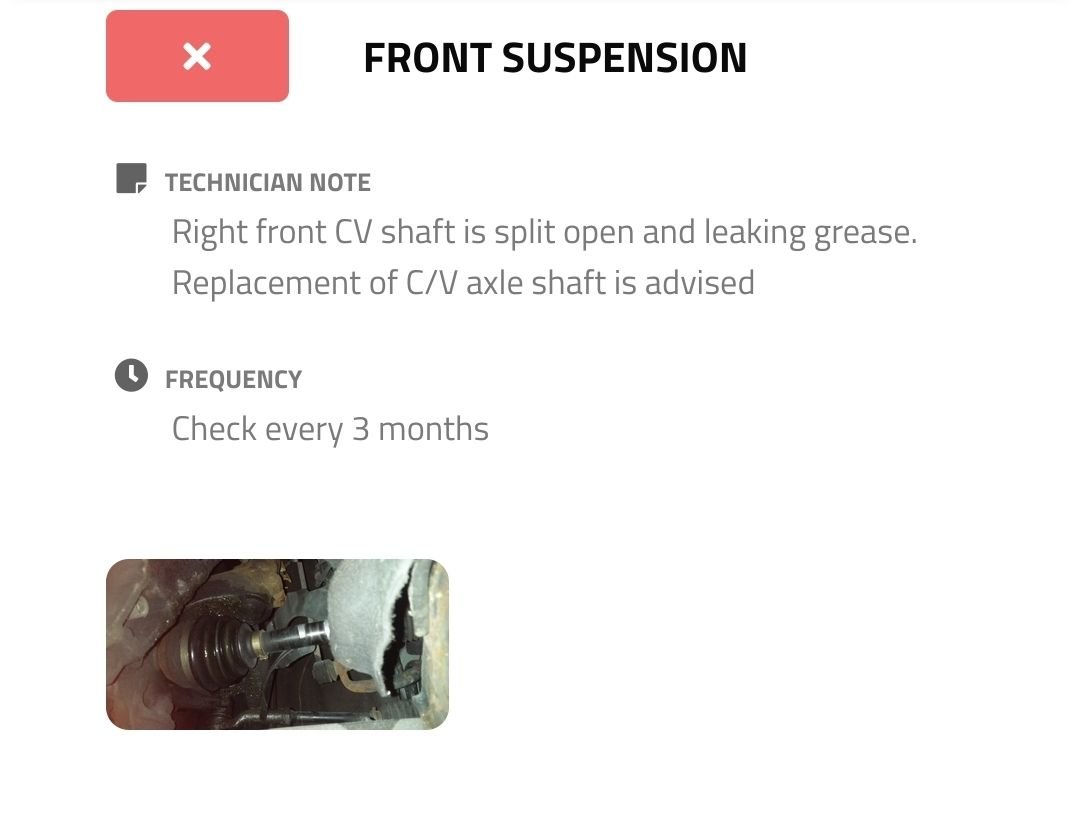

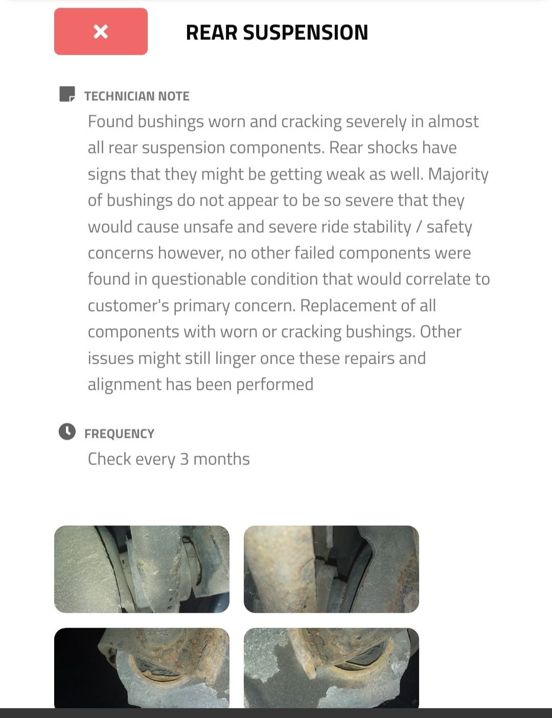

Hey all,
Have a 2017 S60 Inscription AWD and have been having a road shimmy issue for months. I have had the tires replaced, rebalanced, and the wheels checked for balance and damage.
After this, it stil gets uncomfortable driving 70 (the speed limit here) with the shimmy. It's hard to explain, but it feels like the issue is in the front, yet when it shimmies, it feels like it's in the back end floats.
Lastly, it seems worse in the rain and snow. I am losing my mind, and my shop cannot find a definitive answer.
I will attach latest notes from my shop That specializes in imports.
