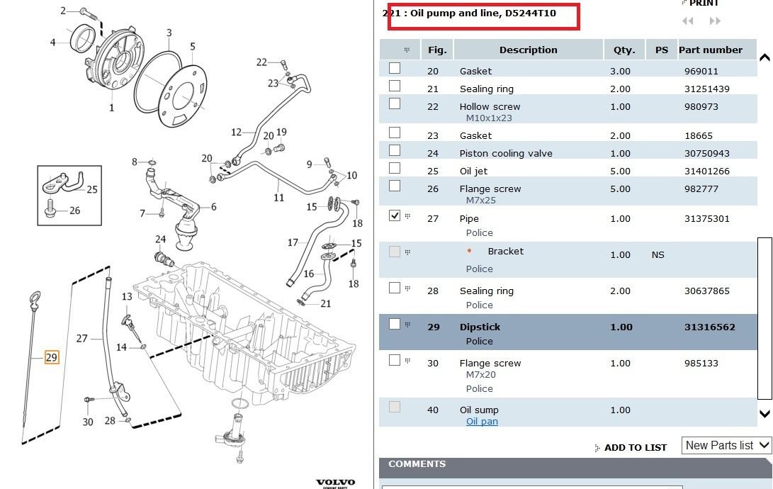

Don't know if anything will show on the dummy stick when full. If in doubt - drain the oil and put the correct volume in.

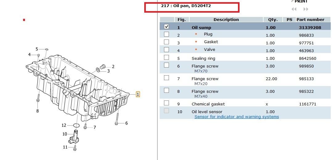

Or - Volvo shows a dipstick available for the d5244.(for the police version) The 2.4 engine uses the same oil pan as the 2.0 (5204). So a permanent manual solution might be to fit a dipstick tube and real dipstick.
