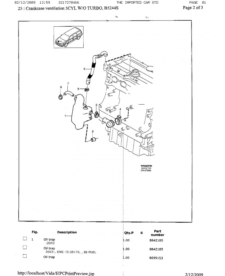

Good morning all. I guess I have to finally pull apart the pcv system on my 02 S60 NA motor due to oil blow-by out the dip stick. It's a high mileage(166,000)car that I have had for a few months. My problem is I can't find a diagram of the system anywhere.(for normally aspirated) so I don't know all the parts I need. I've tried looking at the vendors sites but I'm not sure if I'll have everything.(I'd like to try to get all parts here before I pull it apart). So if someone could be so kind to direct me to picture or parts list I would be very greatful.

I'd like to see that also. Here's a diagram from a volvo parts dept., for the non-turbo version. And this link shows the layout for a turbo version (which I don't have, and looks considerably different): http://turbobil.com/SMF/index.php?PH...176&topic=37.0

Good morning Tim. Thank you very much for the picture. I am able to find parts #1,7, and 8 on line but I don't see part #2. By chance, do you have a Volvo # for #2? Again thank you for your help.

No -- but I think you could call a dealer parts dept. and get it. That's where the drawing came from.
