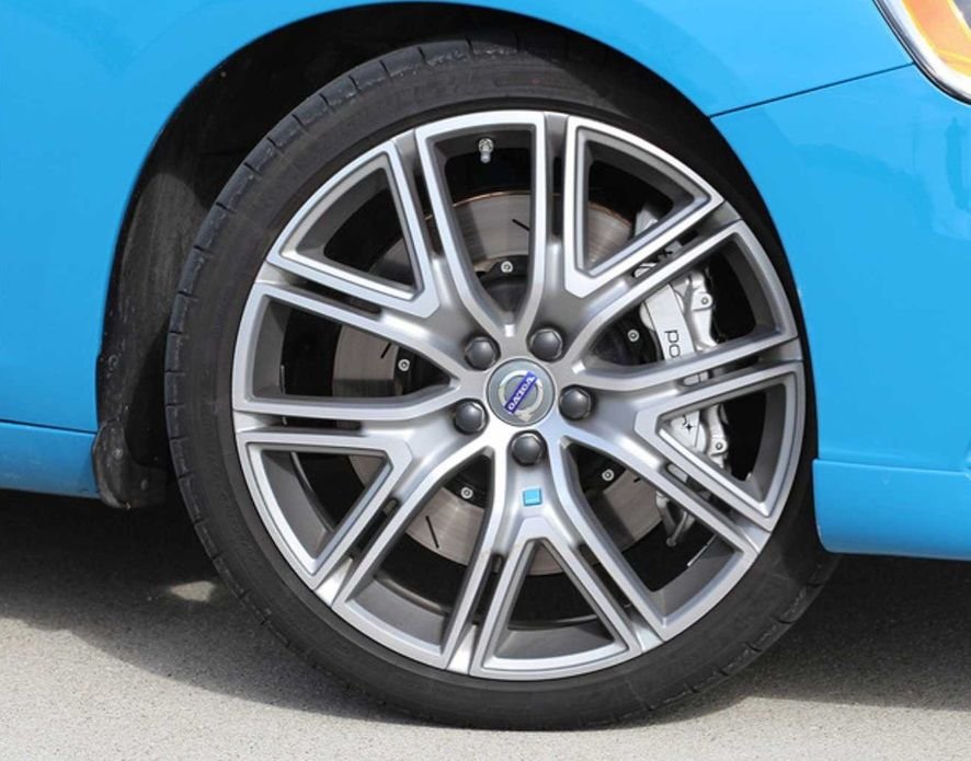

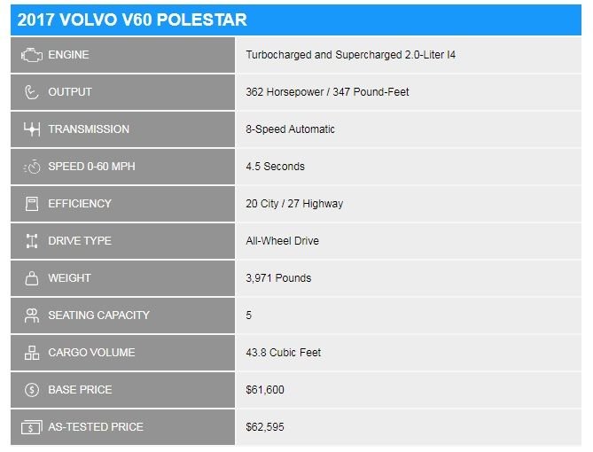

Don't think that's a " Polestar". It's a s60 r design platinum trim with a bunch of polestar add-ons. Does it have the front calipers and rotors as shown below?
Here's a review of a "Polestar" car. Or google 2017 s60 Polestar and you will be presented with a bunch of blue car pictures. (and writeups). Note the pricing difference between s60r and Polestar trim -

Thanks - this sure is getting confusing! The photos I've seen of the vehicle in question have the Polestar door sill badging, the shifter badging, the rear right panel badging, and a Polestar badge on each 21" wheel - but no engraved rotors. But the Performance section shows S60 R-Design Platinum specs: 2.0L Super & Turbo-Charged, Direct Inject Engine 302 HP @ 5700 RPM and 295 lb-ft Torque @ 2100 RPM. As you've noted, the full-on Polestar model has 362hp. But the S60 I'm looking at also has the $1300 Polestar tuning package, so is that basically achieving the same spec? The sticker shows this pricing:
