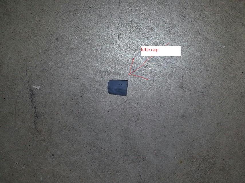

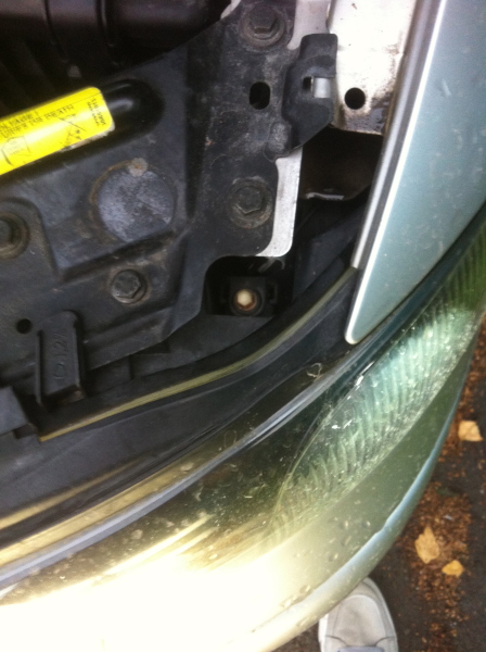

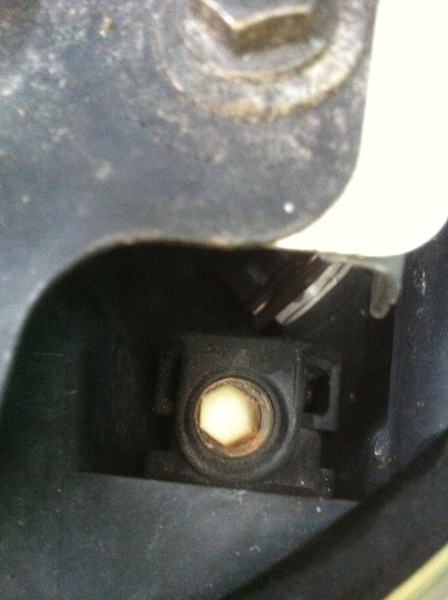

Old Sep 26, 2013 | 12:35 AM
blackbrick's Avatar
Joined: Apr 2009
Posts: 448
From: Phoenix,Arizona
pctures of location and the cap
