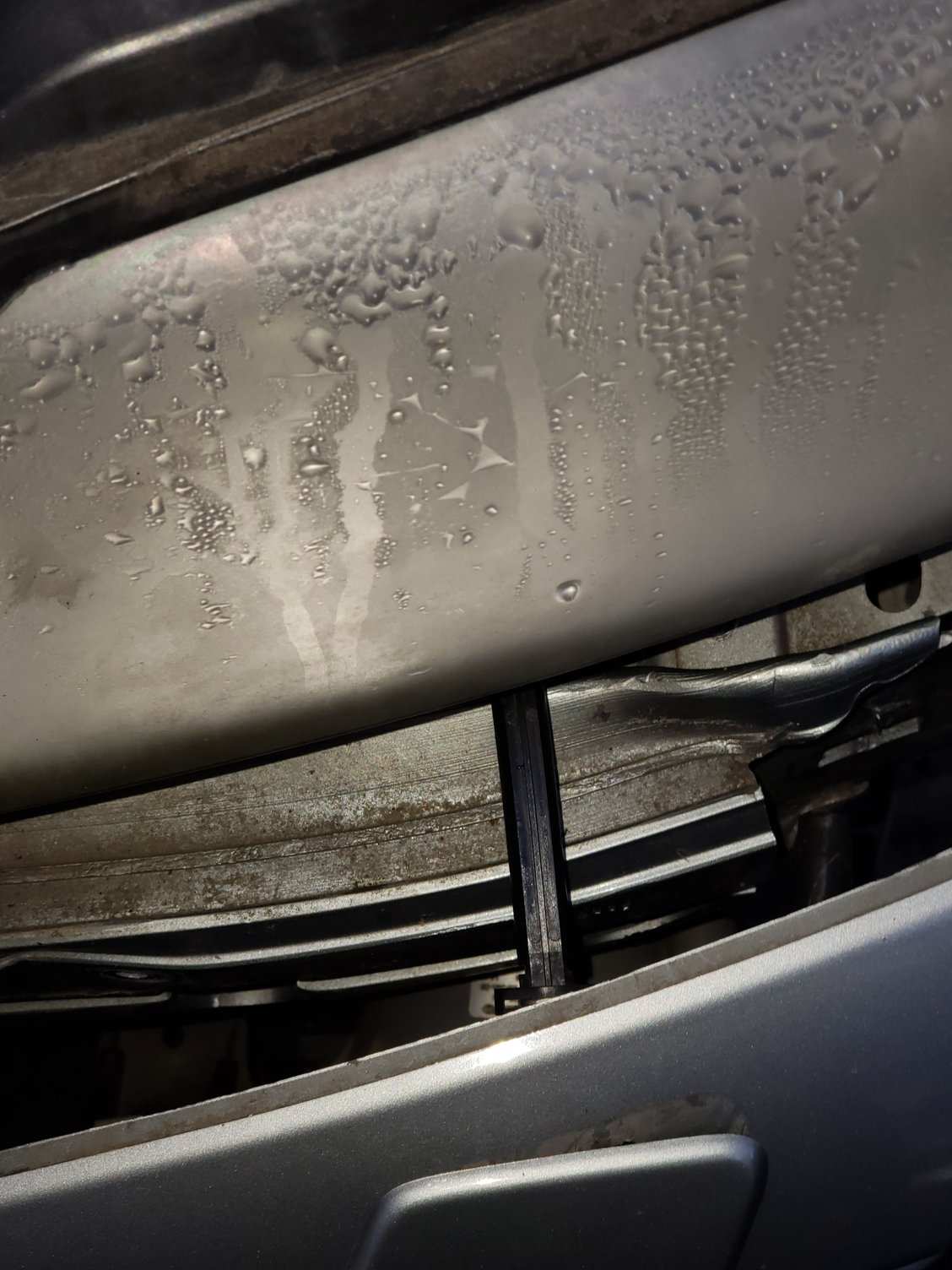

So I watched
on how to remove the headlight on a 2001 - 2009 Volvo S60 and I've pretty much followed it to a T but I simply cannot remove the bumper as easily There's this black piece that's prevent me from removing the bumper completely
IS there anything else I should remove?

Headlamp washer.Not shown in the video.
Been a bit since I pulled the front bumper on my wives S60 but there should be clip holding the washer nozzle cover onto the extending rod. Pull the clip and the cover off so the bumper can come off.
