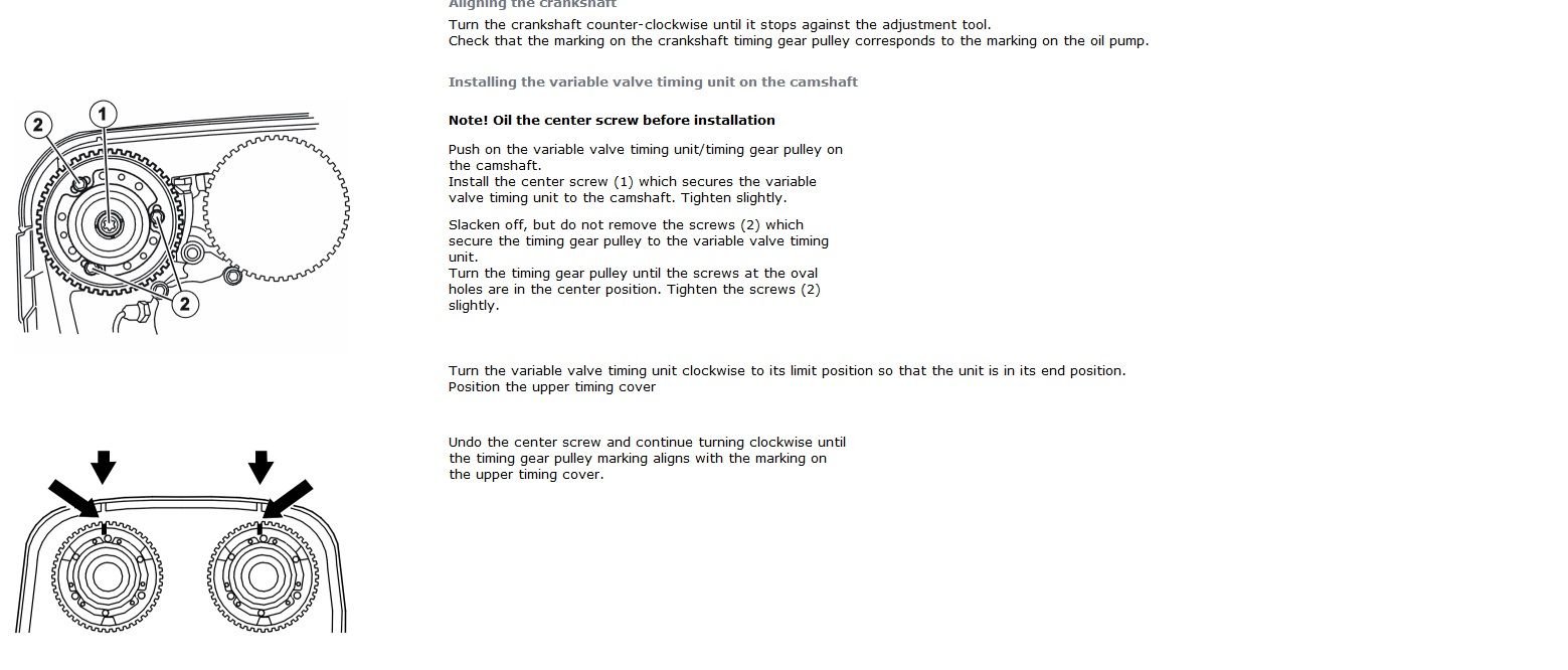

Hi forum i have a S60 that broken timing belt, i repair the head and now tried to make the timing but the cvvt in the Exhaust not spring... I remove the torx Bolt and turn in clockwise late tight and not spring the hub... Any idea???

Do the instructions say anything about a spring loaded hub on a 2002? Sorry it's late here.

Thanks man You always answer me, dear my engine is b5234t3 with vvt only in Exhaust, can You give the complete PDF for install sprocket and timing belt? Thanksss

Dear i have the vida 2014 where fine this information??
