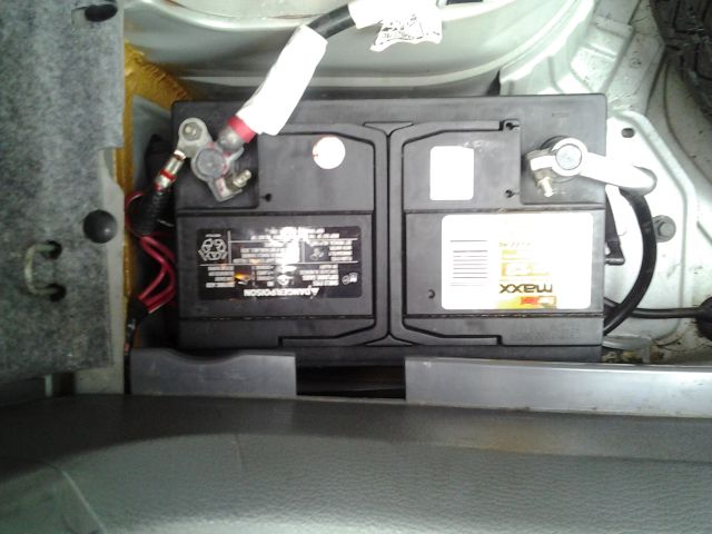

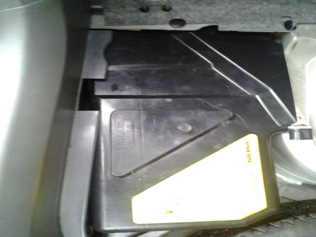

Well I pushed and prodded and bent to the point that a crack appeared.
In the battery stuck picture the problem is that it is stuck on the ground cable (can't push down or to the right to get past the cable to where the cover is cut out for the negative cable. In fact I am not very thrilled at how the negative cable feels. It feels a bit wobbly like it has been pushed on one too many times.

Can't blame the engineers for someone putting the wrong size battery in. The cover shouldn't need to be cut. You can also leave it off of you want. Starting in 06 (I think), they didn't get covers.

My anxiety was with the cover. I'm not sure if it is the battery being too large but it is definitely the ground strap that goes to the body.
I don't see any reason to have it over the battery. Removed the cover in 06 --- I'll pretend my car just got an upgrade to 06 and leave the cover off the car.
One thing for sure, with the cover on ... if you needed a jump you would need the wrench to remove the retaining nuts on the metal holder on top of the battery cover.
So I may just keep that cover off.
