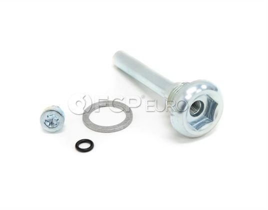

Sure - warm trans fluid up to 50degrees Celsius. (verify temp with compatible scan tool) With engine running shift into all gear positions, 2 seconds in each gear and do that twice. With shifter in park (engine still running, car on a level surface) remove the belly pan and the inner drain plug - be prepared to collect escaping (hot) fluid. If no fluid comes out - the fluid is low. If fluid does - the fluid is high. Careful - the fluid will be hot! Drain till it stops leaking. If low be sure to turn off engine to top it up - Put plug in, add fluid, warm new fluid to 50, then repeat the procedure until fluid leaks out. (and stops leaking) Use a new seal on the inner drain plug. ( i'm certain you saw the level tube built into the outer drain plug when you had it out)
