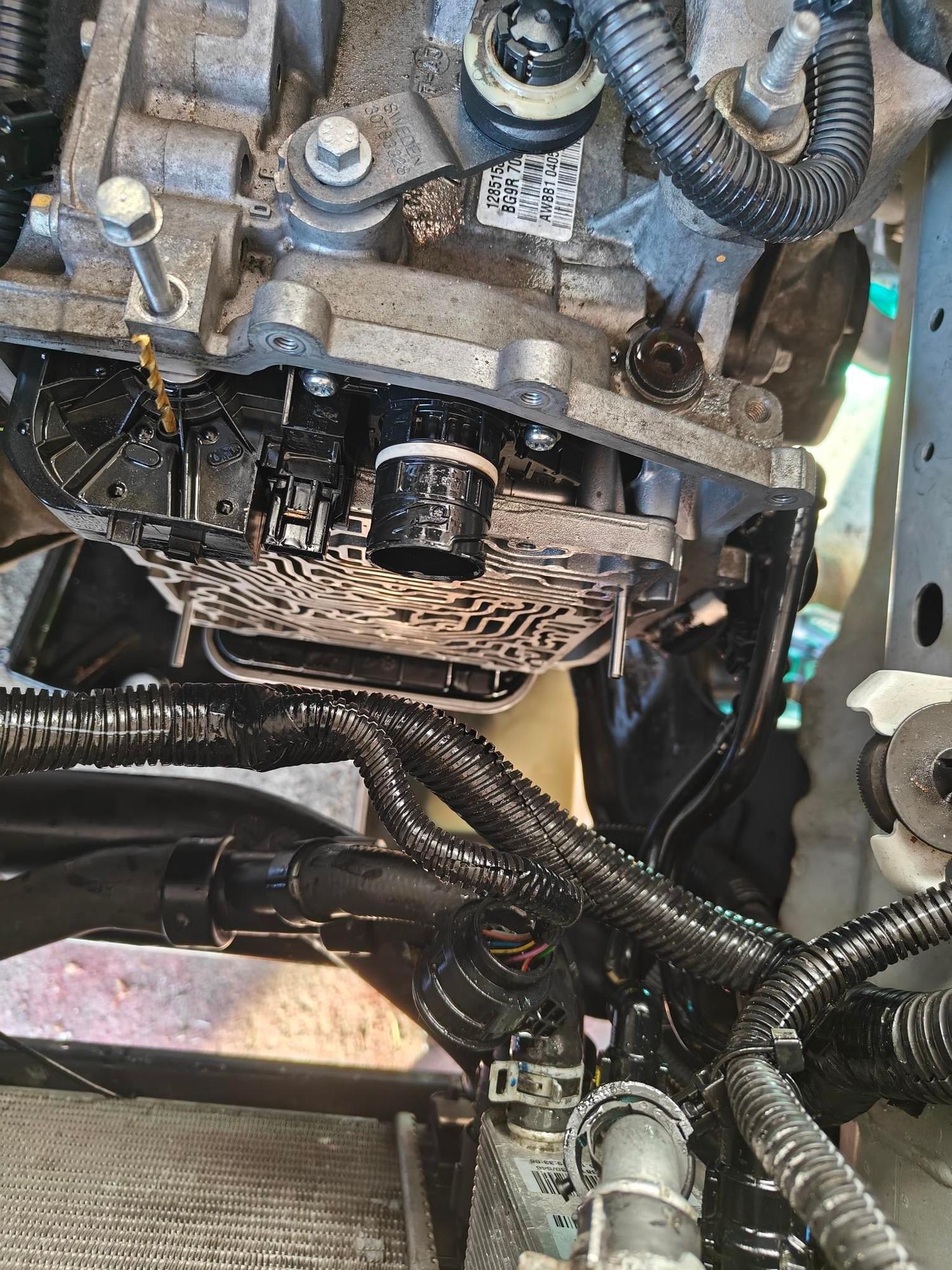

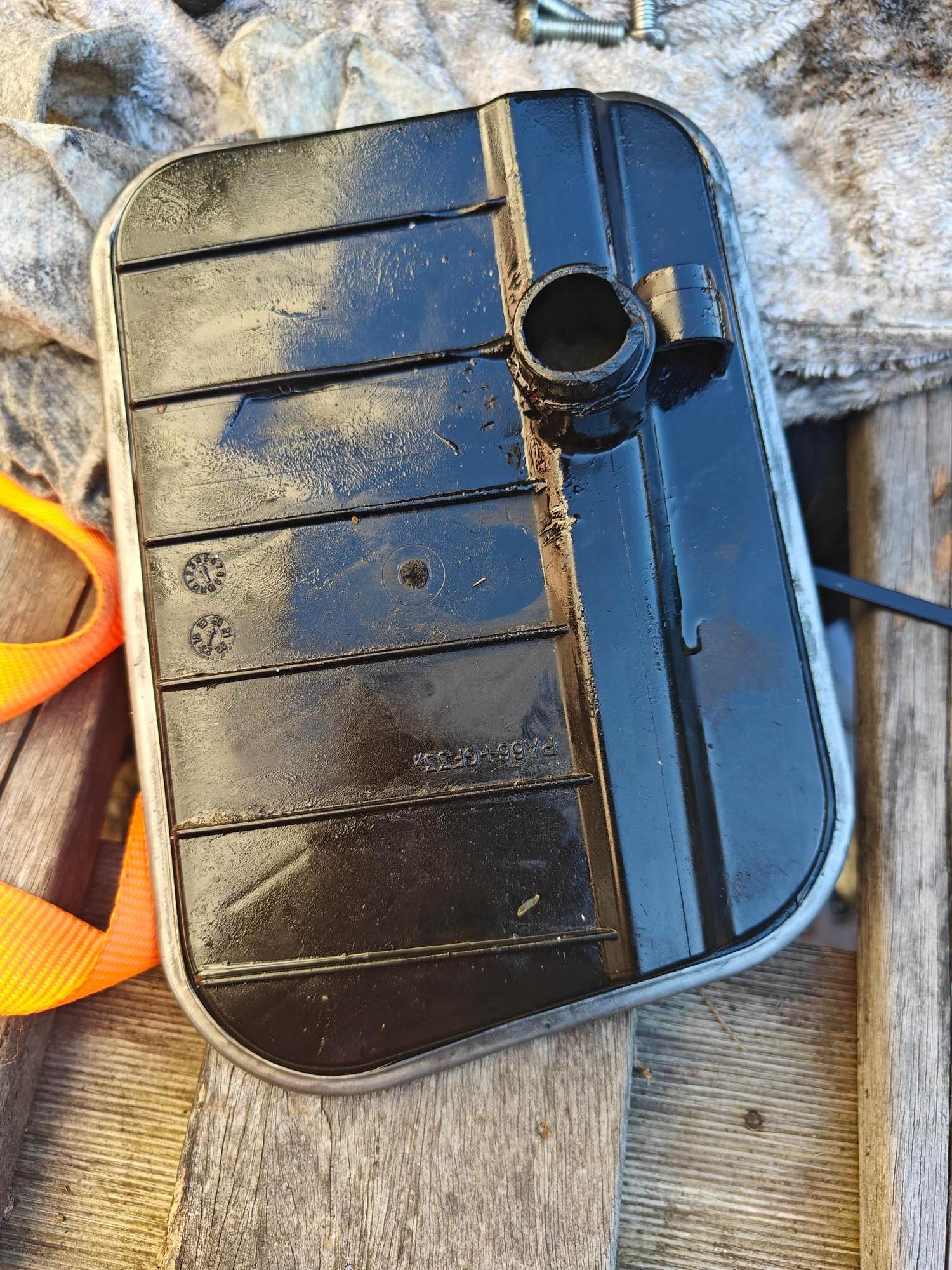

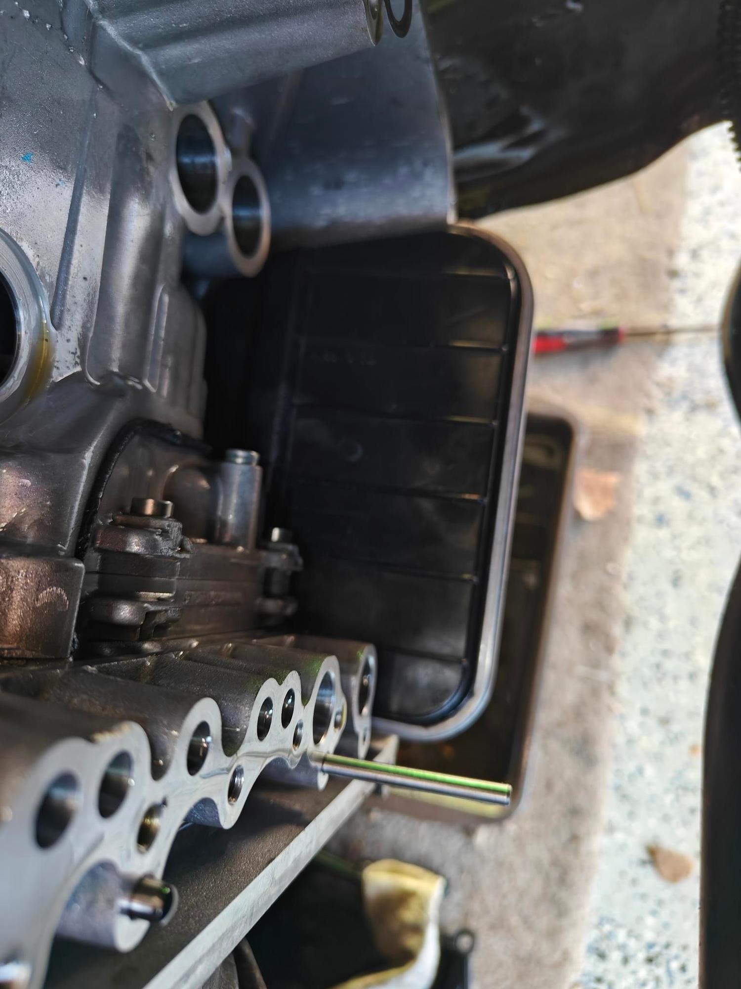

Removed Vale body and mechatronic, cleaned all solenids and, managed to removed internal filter which took me 3 hours.

BOught two bottles Penrite DCT ,about 8 L, removed cooler and lines, flushed everything.
I put mechatroinic in first then valve body, so you don't need to remove coolant hose and drain it.
I niearly filled 8 L, only about 2-300 ml left.
It's fresh internal filter and external filter and every solenoids works like charm.
It's working beautifully with any issues or shuidder.
Temp was up to 91 then thermal stat kicked in, cooler started working, Temp drop to 80-85 when driving.
NO codes whatever.

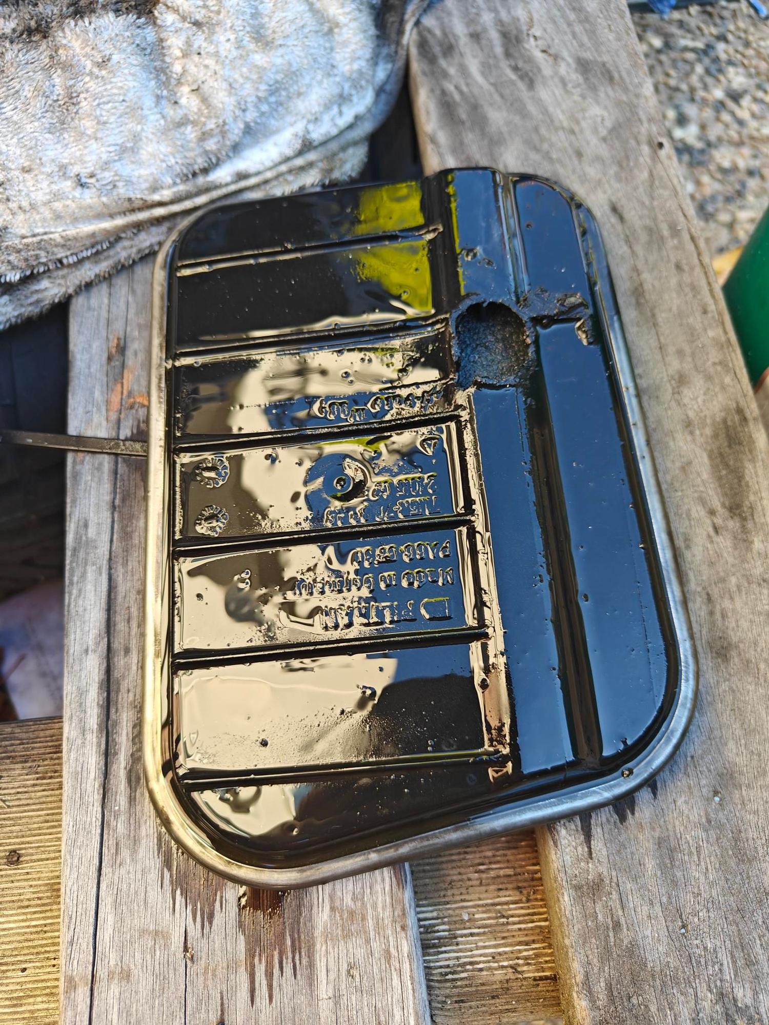

It looks like it's caused by clotted internal filter. look how dirty it's.
