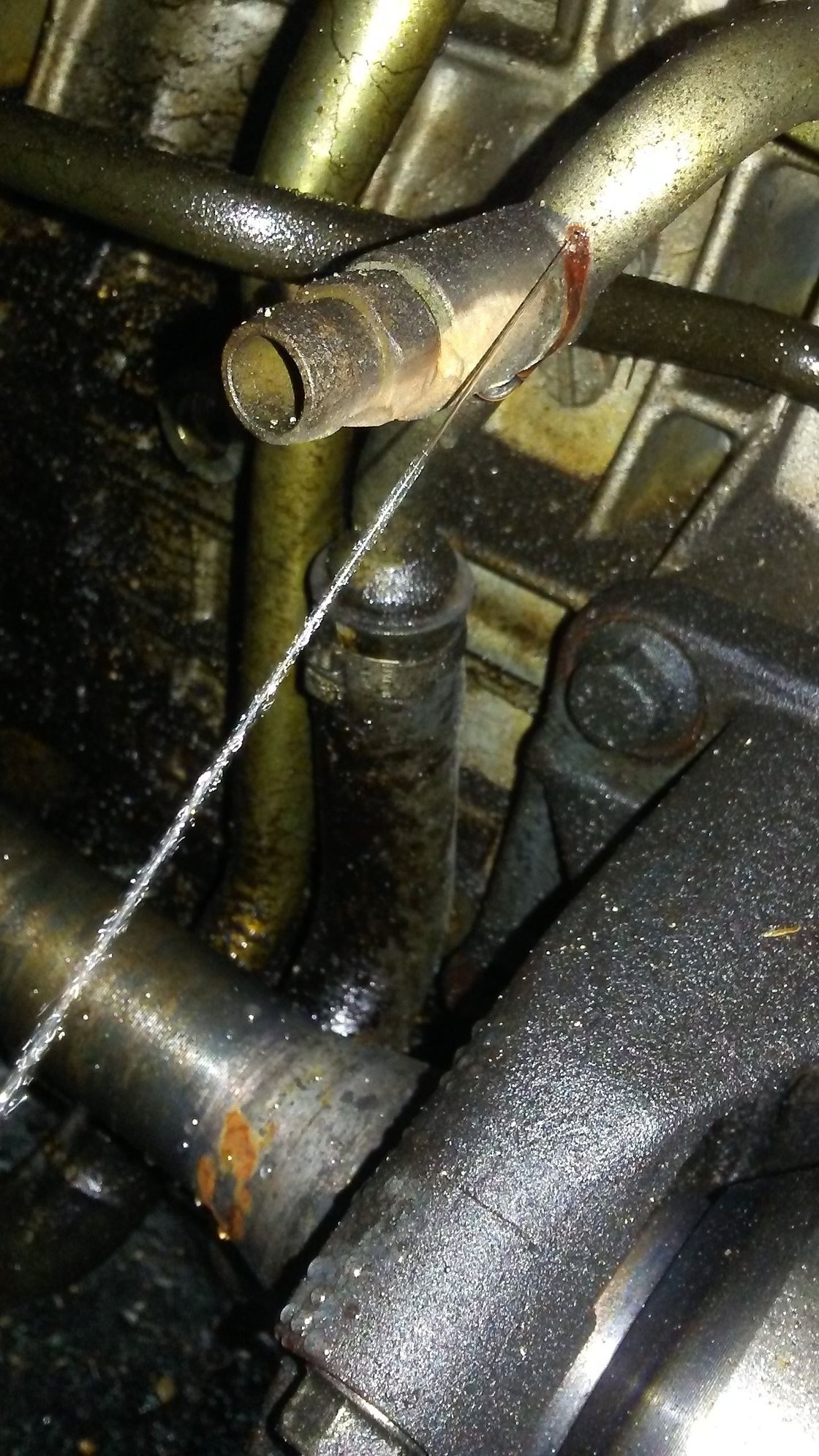

hello guys:
I've been trying to find the name of this part to no avail.
The pipe is from an s60 2002.
Among the different names they gave it, the shop said it was the oil coolant pipe, coolant tube. And they may have called it by another name that I just can't recall now.
When I googled it using those different terms (coolant tube, coolant pipe, etc) I can't match from the diagrams the dealers show to the picture I took of the leak.
Only after I removed the cap of the reservoir, was the leak visible enough to see. It actually started only after that. I have no idea why it'd do this, but as soon as I would screw the cap back on the reservoir tank, the leak would stop. Was this because of the air flow?
The car can be driven for a short distance, but anything longer than that, it would run out of fluid.
The shop had ordered the part that supposedly matched that one (as seen on the picture), and today they said that they had received the wrong part.
If anyone can tell me what the name of this part is, I'll appreciate it.

That's the rear water pipe.

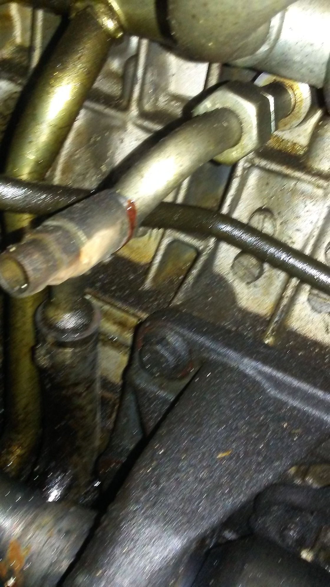

Thank you. But is there a diagram image that would resemble this pipe? The drawing doesn't have to be identical, but I'd expect some similarity. Let me just post another picture.
I've looked at a few of these, and nothing seemed to look even remotely like it.

At some point they integrated that drain nipple into the water pipe, which is why I thought it was the water like from your first photo. The second one showed it was the older, separate one which helped clarify.
