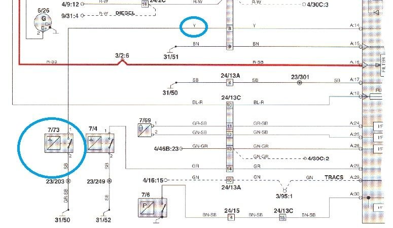

Looking at the wiring diagram, pin number 1 is a brown/gray wire and pin 2 is a black wire. Pin 1 goes to the light on the instrument cluster, and Pin 2 is a ground coming from the instrument cluster,. Pin 1 will only have a ground signal on it (and hence illuminating the light), when the sensor in the coolant bottle closes and sends a ground signal.
SO......the way I would test with a multimeter is: First I would meter resistance between the pins on the coolant sensor in the bottle to see if they are shorted together. With the proper amount of liquid in the bottle they should read open or infinite resistance, and with little or no liquid they should read shorted or zero resistance. If that checks out ok, then meter out the wires at the connector. Pin 2 should read zero resistance between it and ground. Pin 1 should read infinite resistance between and ground.

So - Resistance on the sensor with tank right side up and empty was 0, or a closed circuit. Resistance upside down simulating full was infinity or an open circuit. Sounds like the tank and sensor work. The bulb is grounded when coolant level is low.
Turn key on, unplug sensor, use a jumper wire to Ground the yellow wire or bridge the black and yellow wires for the sensor, warning light should come on, and go off when disconnected. The yellow wire goes directly to the bulb, black wire is connected to ground. In the diagram 7/73 is the level switch with a SB (black) wire on one side and a Y (yellow) wire on the other. Yellow wire can be found in plug A, terminal 14 on the back of the instrument cluster.
If your warning light stays on with sensor unplugged - it's not a bottle or sensor problem, the yellow wire could be grounded somewhere. 7/4 is the brake fluid level sensor if you were wondering.
