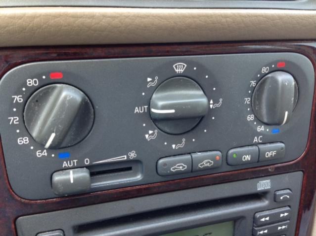

The center dial on my S70's climate control unit doesn't do anything... no dampers change to adjust air flow. The other two dials do work, and the fan adjusts its speed to match the thermostat setting selected. I had the dash out twice -- once to fix the broken dash mount brackets and again recently to perform an A/C evaporator replacement.
Any ideas on how to debug this? I'm assuming that when you adjust that dial, it's not a mechanical linkage--a step motor somewhere is adjusting something that maybe I didn't get reconnected correctly? Fortunately, the air is blowing out the main dash vents, so the A/C is working fine (cooling ME), but this could be a problem come winter if I can't get heat to the windshield.

That an ECC (electronic climate control); does it flash any codes when you pwr it up? If so, read them; that's where I would start.
