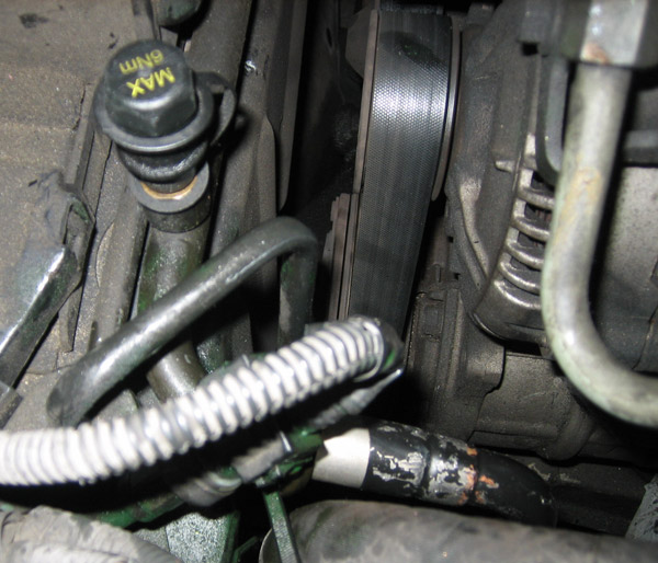

I had a non Volvo mechanic work on my car, and he put the car on a lift to replace the drier. He got it into place, but he said the connection popped off later when he was charging the system. I'm guessing the green I see in the photo I took is the oil/dye.
Now, he says that he cannot get the new accumulator to connect to the line. He said I will need to buy a new low pressure line! Is there some trick to connecting the accumulator? He said the connection is like how the evaporator connects, and that one was easy, but this one isn't working for him. My accumulator came from FCP Groton, so it should be OEM and fit properly ...

Does the spring sit completely be/w the line and the drier? I'm wondering if maybe trying another spring might have been worth trying. Of course, he might have tried that, I but I don't know. In the photo I attached, what components am I seeing?

Also in the pick that dryer looks like an old one or he tore it up pretty good.

That is the new drier! He showed me the old one, which we tossed. Yeah, it's torn up pretty good from his many attempts at getting it to connect properly. I think he said the connection is just like the evaporator connection, and that one went in easily, and that's why he was surprised this one was so difficult.

Yes it is the same connection. He really tore that one up.

I took a look today, and it looks like he must have a set of plier around it. I was able to scrape part of that black coating with my fingernails. Is it supposed to just pop into place with some wiggling w/o tools?

Yes it should. Also if the edge of the dryer is damaged at all where it goes in that will give you a hard time going in.
