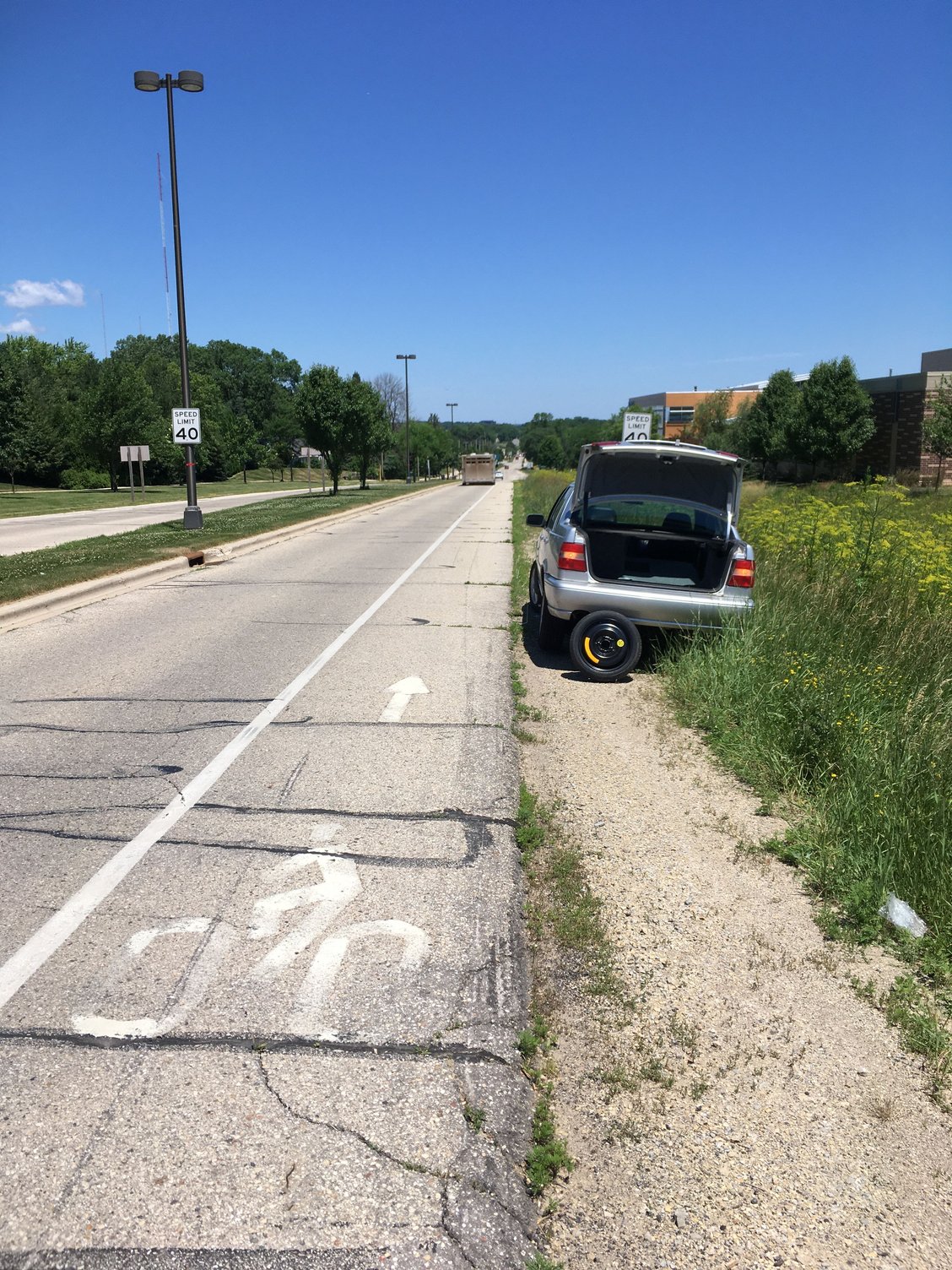

A couple days ago ended up with a front driver flat. 11,000ish miles on tires. Kinda cool the jack jacks up the entire side of the car.
The bad. The stubby factory lug nut wrench.
1. it’s short. Could not get any of the nuts free and I bent the wrench by hand.
2. for lack of knowing what the proper term is I’m going to name it the nut cup. Seems to be a softer metal, see up above about bend, as it was not grabbing the nuts, lugs, very well at all. Kinda rounding out the inside and not doing the lugs any favors at all.
A couple street workers recognized my situation and had a portable impact wrench that worked.
Lesson learned. Carry a good sized breaker bar and a 19mm socket.
