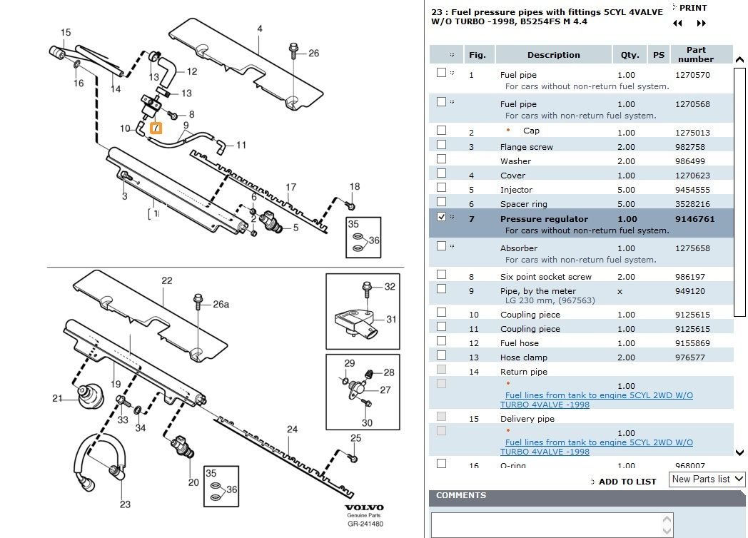

I have the same question; I've spent some time poking around the fuel rail and don't see anything that matches the image of the part I need. Could someone give me more detailed instruction? Do I have to unscrew something to expose the FPR?

That's a 99-2000 car. There's only one fuel line going to the fuel rail so you have a non return system with the fuel pressure regulator as part of the fuel pump in the gas tank. Your throttle module looks old - are you aware of the common problems with them?

hmmm, I thought the FPR on the 98s was similar to the 850s where its located under the intake manifold between 1-2. See if the Volvotips.com web site shows anything for the 850s that seems to match to your 98 S70.

You're right. But this thread is now two conversations, one about a 1998 that was answered in 2008, and one not.
It is on the 1993 - 1998 fuel systems that have a return line. The most recent question was about a 1999-2000 where the injector rail looks like the bottom picture.

Thank you for the help... as you can tell this is my first time learning about all this.
It does look like the bottom picture! But I don't see a FPR in the bottom picture. I guess I have to unscrew the fuel rail to access it, or maybe it's not connected directly into the fuel rail?

Old Mar 16, 2022 | 07:25 PM
Originally Posted by 500usdBucket
1. But I don't see a FPR in the bottom picture.
2. What are the problems with the throttle module?
1. As stated earlier the fuel pressure regulator is part of the fuel pump - inside the gas tank.
